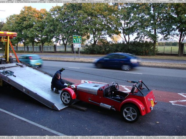

oh well ........
posted on 2/10/09 at 10:01 AM Reply With Quote
sold? broken? dead?
02GF74
posted on 2/10/09 at 10:04 AM Reply With Quote
dead big time.
overheated, reckon at least a head gasket, possibly more.
don't want to even think about it right now
question is why?

yey, that is the A406, just off the A1 towards Stevenage.
been thinking about why.
I set timing static to 10 BTDC but didn't check it when running but it ran ok.
I fitted same dellorto carbs as for the 1300 - didn't check jetting but it ran ok.
The signs that there was something not quite right was that every time I stopped the fan was running which should have told me that the engine was running hot.
Also fitted new thermostat; haven't checked that yet but will be extremely well p155ed off it that is at fault.
iank
posted on 2/10/09 at 03:33 PM Reply With Quote
May have been running lean then, that would cause it to overheat.
