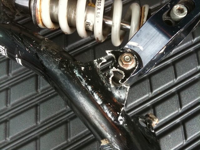

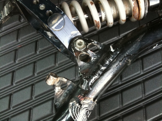

Okay, have tried the local resources and none have been able/willing to help. Just looking for someboady who can weld a couple of new brackets onto a
mountain bike frame. Beer tokens waiting for anyone who can oblidge....Oh and don't worry I won't hold anyone liable if they do it and then
it breaks (its allready been welded once and snapped again.....grrrr!). Will try and attach some pictures. U2U or e-mail me if you can help me out.
I can post down and pay for postage back to me plus your time.....Thanks.
  Bike Frame 2
  Bike Frame 1
  Bike Frame 3
  Bike Frame 5

ETA - actually, looking at the pictures, the weld hasn't gone, rather the bracket, which should make it easier to weld, but if it went once,
unless you make it stronger, it will go again...

it would be a much better/stronger job, and easier for the fabricator to cut off the remainder of the bracket, make a new one out of slightly thicker
material without the extra holes in it that are obviously weak points, and weld that in place instead.
you will have a real game trying to weld up the 3 small places where it has snapped

Yeah, I am hoping someone can lop off the two brackets and make two new ones out of either the same thickness of material or slightly thicker. The
company that welded it first time round have gone bust. I'm not sure why they saw fit to cut the holes in the plates! That is why they have
gone - not because of the weld or thickness of material.
The Ali is 6062 (according to the sticker on the frame) and will be a high-grade alloy so should be free of most impurities. As far as I am aware
this shouldn't prevent any problem when welding and doesn't make it any harder to do than anything else. I have an AC/DC Tig but it is in
storage, I have no gas and I can wled Steel no problem but only ever managed to weld some thick (>6mm) ali plates together. I just burnt holes in
the think stuff so need someone more skillful! Thanks,
Oh and no I don't think Rivets would be good enough....wouldn't want to risk doing damage to other components if they failed....
