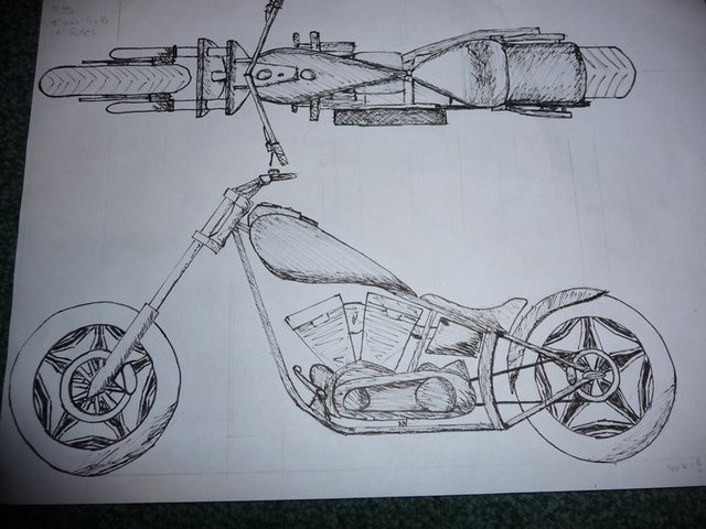

This is a rough sketch of the overall look I am aiming at:
  Desin rough
No doubt things will change and evolve as the project progresses.

Awesome engine. I know it's not the done thing and I'm not really into choppers but have you considered having rear suspension, something
like Harley softail if you don't want it too conspicuous.

The frame is softail yes - hardtails are too skittish around the bends by all accounts. The hard tail look is cleaner - but I consider that to all be
part of the challenge!

The Exile bikes are lovely and the bloke is a true nutter. I like the clean lines and I must say theres going to be a little inspiration drawn from
them.
