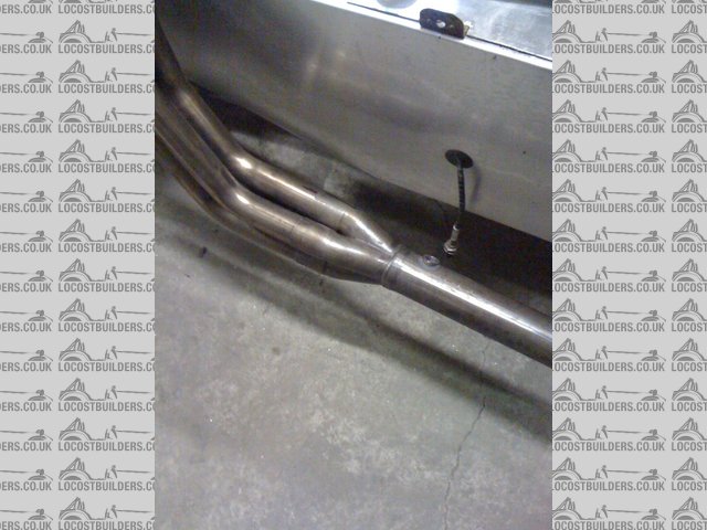

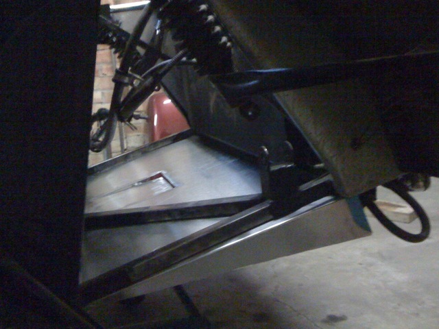

I've managed to remove the axle and change over the crownwheel and pinion, Make an under tray to control airflow into and around the boot area,
knocked up some upper wishbones only to find they are more suited to my mates racecar!! so I'll make another set and fitted my new exhaust
collector. Just gotta get the steering rack sorted, make a new silencer, re-wire the back of the car and make a section of channel to hold the flap
clear of the diff on the under tray.

Looks good Dan, i like the exhaust.
