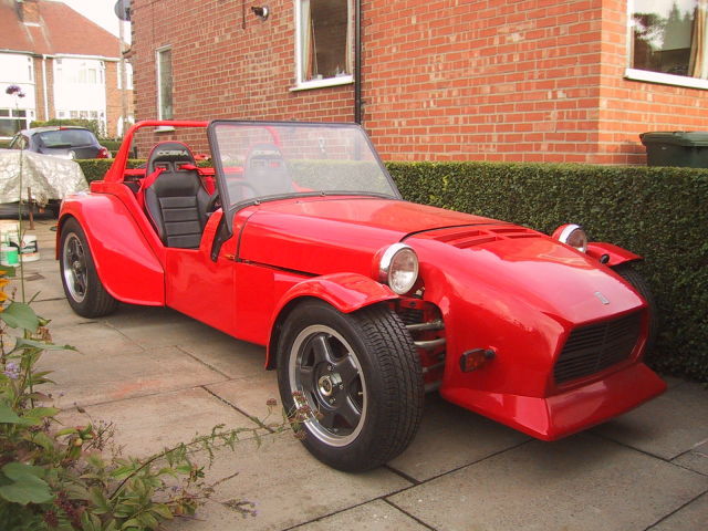

Spyder Silverstone Build Diary
Last year I bought a 1998 Spyder Silverstone. It has never been registered or driven on the road. I am now preparing it for registration and IVA. This
is a rare car, one of only 28 ever made by Spyder engineering In Peterborough. It has a Toyota 1600 2TG engine coupled to a Toyota T50 gearbox and a
sierra diff. Fully independent suspension and a very well engineered chassis.

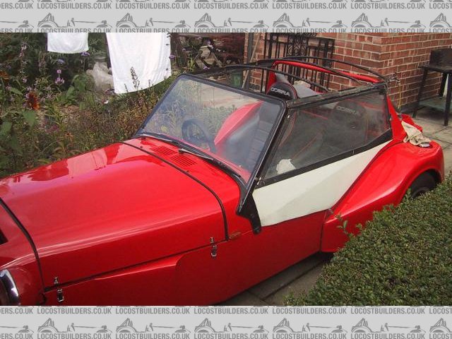

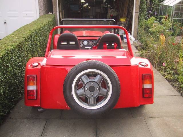

Here are some photos.
  Spyder Silverstone

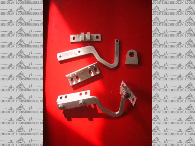

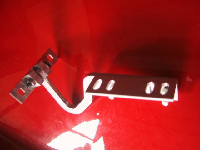

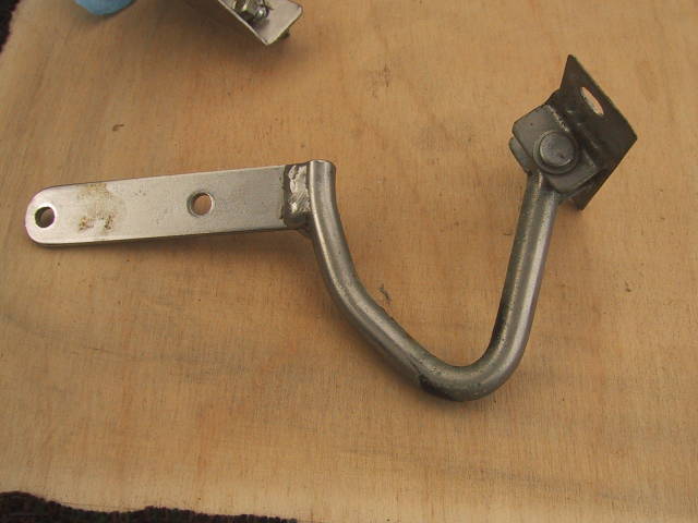

My fist job was to make some boot lid hinges. The car did not come with any and they are not in production any more. Fortunately my friend has a
Silverstone so I was able to make copies from that.
This is the original type of hinge.
and this is my replacement machined from aluminium alloy.

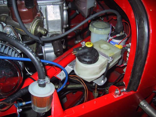

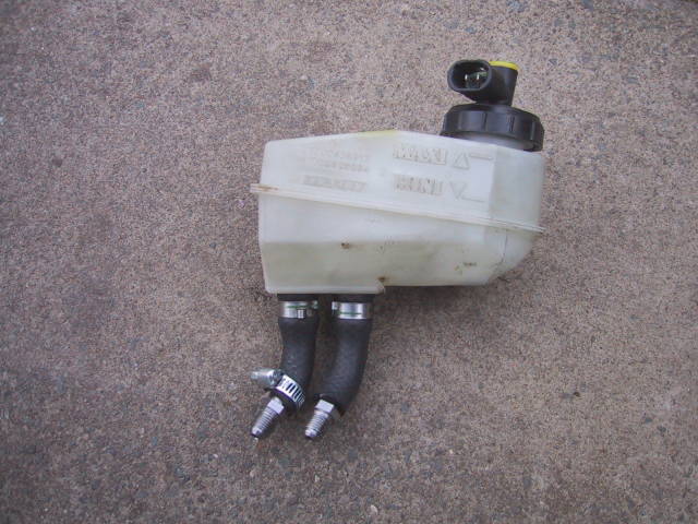

Next up was the brake fluid reservoir. It was fitted with Girling pots, the cap was missing from one of them and they don't have level switches.
The master cylinder is remote from the reservoir so I bought a reservoir for a mk1 Megan, machined up pipe adapters and made a bracket for it.

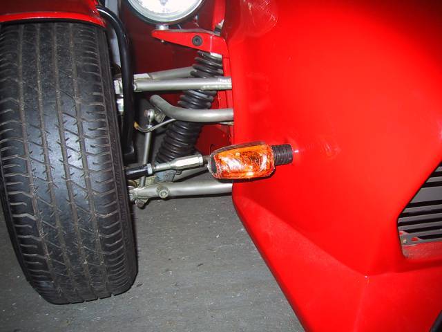

One of the indicator stalks was broken and I was worried that they might sit a bit low for the IVA. I found a brand new pair of these at the Newark
auto jumble for £4.

I use it all the time, I made some ally doors that I copied from a photo Vic Moore gave me of some prototype they were doing,they may not be as good
as the ones Spyder made but they make driving it much more civilised and with the hood up most of the rain stays out.
Mine is well used and it shows but drives well. Never seen another one on the road but its nice to know there are others about, I'm situated

I've had my car for 7 years. It was in a bit of a state when I got it. To some extent it still is!
I replaced the original 2TG with a 2 litre 3SGE but I retained the T50 gearbox. It was a hell of a job. Lots of machining and one off bits. All worth
it in the end though.

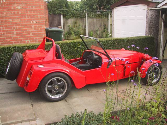

Anyway,here's mine........
Geoff
( Not trying to hijack your thread Chris, but it's becoming a bit of a Silverstone Archive! )

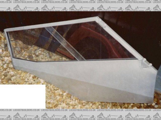

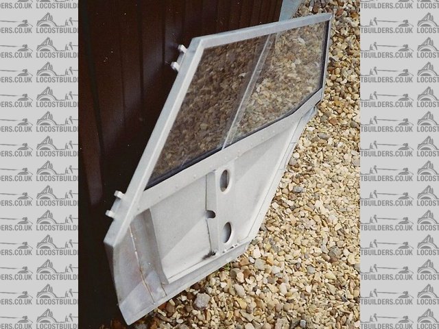

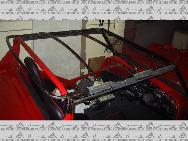

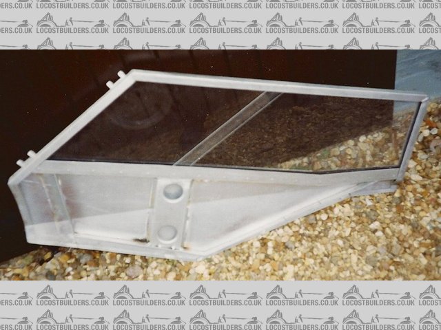

Tony, it would be great to see some photos of your car and the doors. Make doors is on my to do list, although a long way down the list. My friend,
Noble, took these photos of the doors that came with a car he went to see when it was for sale some years ago. It was a factory race car and is now
owned by Trevor who lives in Andorra.
Apparently the doors and a hard top where going to be an option but never went into production. This explains the roof bars that came with the kit
enabling the roof to fit over the tops of the doors.
This photo is the doors that came with Geoff's car but temporarily fitted to my car. Although they are not the right colour, I think they suit
car quite well.
[Edited on 20/3/11 by chris-g]
