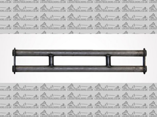

FFS, I just want to buy two 1.5m lengths of steel to make my front suspension beam with. Something like this...
It needs to be strong as the whole front suspension effectively hangs off the ends... lighter would be good, but no unobtanium (as I'm skint!)!
The biggest PITA in the whole process (apart from me being a complete and utter bunghole) is that the only thing that's important to me is the ID of the tube / pipe... and yup... no suppliers list the ID of their steel!!! Buggerations... I wish I'd paid even a teeny weeny bit of attention in maths classes!
I need 49.5mm (or nearest size available) ID for the bottom tube and 45.9mm (or nearest size available) ID for the top one
Can anyone who knows their (steel) onions help out Mr Thicky MacGump!?

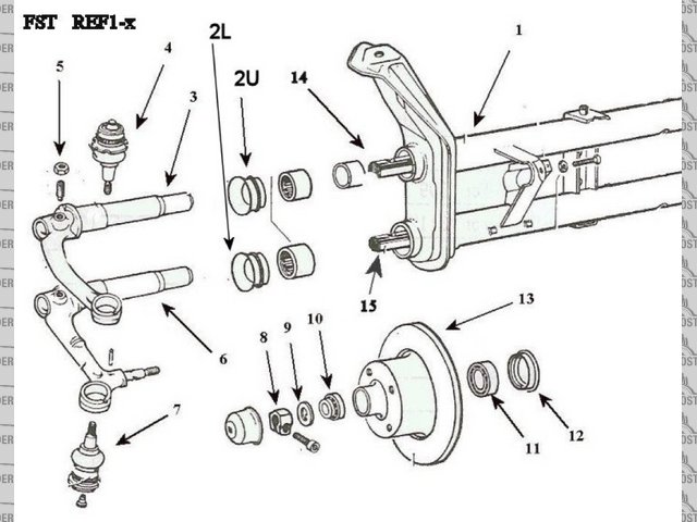

I've been skittering about various suppliers. Some are using inch fractions, others mm's, others swg. There's even a few who use a mish-mash of all three!
I'm just struggling to find two tubes of the same grade of material that get within a mil of my requirements.
I'v attached the pic below of a VW beam, so folks can see the relevance of the ID above all else.
