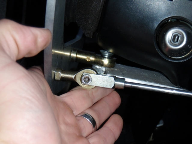

I used an M5 rose joint with exactly the same setup you are trying.
I had to spread the clevis slightly but it works.

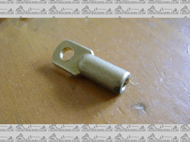

[img]
[/img]
Is this any good?
Its a standard cable end for a 33C cable. M5 female thread, 6mm hole in lug end, cadmium plated steel.
If you want one U2U me and I will pop one in the post.
