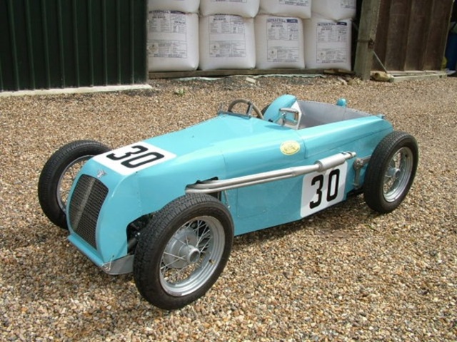

The sly blue car (number 30) is brilliant.

designer: the blue car is an Austin 7 Special made by Pigsty Racing.

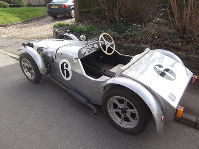

I like the concept you are after. I quite like the Silver 'competition numbered' 6, a style I could live with. I recently found this pic
online, which is very well done, it's a Austin Ruby body on a Caterham chassis.
Personally I would have put some more 'period' wheels on than those, but a fine car none the less.

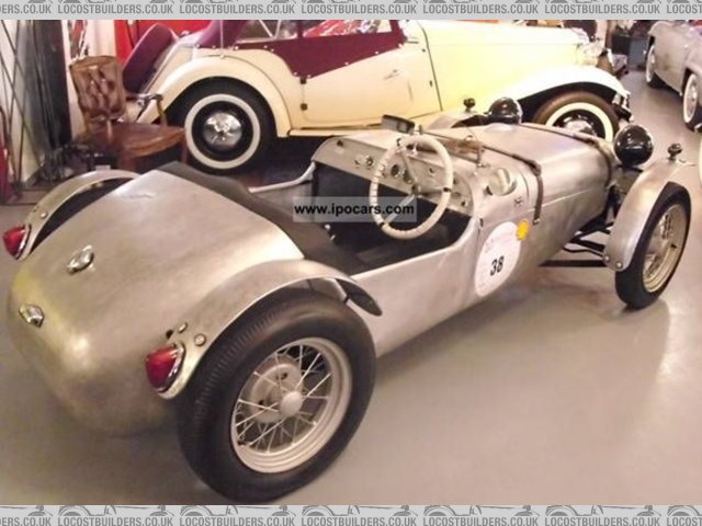

I,m liking the rear of no.38, always felt the rear of my locost looked bulky.
I hanker for something period, although further back in time using a jag engine and a LDV or DAF chassis, even have the wire wheels and gearbox ready.

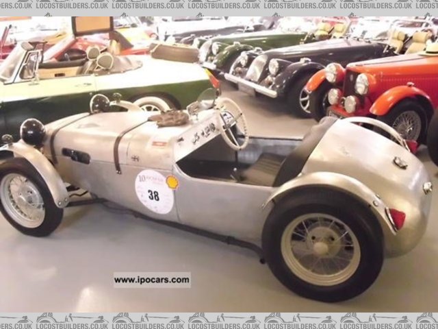

Mark Chandler: No 38 is a Speedex, an Austin 7 Special made by Jem Marsh, who went on to found Marcos. I think my time period is later than yours.
iank: the Buroche was a Ford Popular / Austin 7 special. This picture was also on the 1950specials website which has now closed. It is also in Steve
Hole's A to Z of Kit Cars book.
