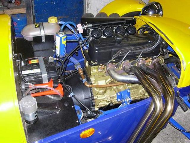

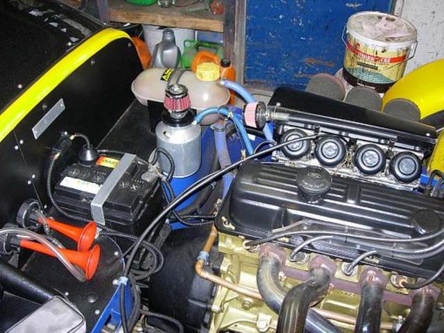

After 2 years using an old WD40 can with a hole in the side I got one of these..
Linky Catch Can
( took about a week to wait )

jacko
| posted on 15/12/13 at 02:32 PM |
  WD 40 tin as catch tank
I started with this and now have a old spray gun canister with a small filter fitted on top
Jacko
