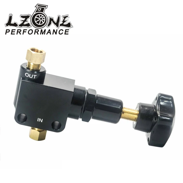

If you're using the standard Sierra Master Cylinder what sort of device is the 'brake bias' that you mention?
Did this part also come from a Sierra?
Is it screwed into the port of the Master Cylinder?
Is it a separate device plumbed into the brake pipes somewhere?
Got any pictures?

I'll get a pic this evening. It's mounted in rear axle the brake line comes from the front of car into this then splits in two left and
right rear brake lines. It has a plunger on top with a bolt that screws down onto it.im assuming to adjust the pressure.do not know where it's
from I didn't build the car.
JAG
| posted on 1/10/18 at 10:51 AM |
Like this?
Justin
