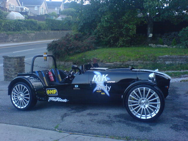

New Wheels! S'pose I'd better paint my drums
The arguments with my son are finally over;
I said my old 13's were fine, he said you'v got to have 15's.
So 15" it is then. (lost again )
Just one problem, the Sierra drive shaft ends hit the centre caps. Bu**er.
Still, at least I'll be able to sort out my mudguards now.
Paul G

Hi Adrian,
Wolfrace Octain with Toyo's
(I'll weigh them tomorrow)
£555 for 5. I suppose somebody will find a site that's cheaper now I'v got them.

no Paul,didn't have any problems with centre caps,but notice your front caps look ok,is the problem just on the rear,I have discs fitted on the
rear.
907
| posted on 20/9/05 at 11:29 PM |
I have 'Tina hubs on the front, they just touch the centre cap
but if I flatten the grease cap a bit they will clear.
It's the back that is the problem.
Either grind the end of the drive shaft down or make a 4mm thick spacer ring.

I had the same problem with the caps on the rear wheels on my MK. The sierra nuts prevented the caps fitting. in the end i sent the caps back to the
manufacture and they cut the centre out and put a raised cap on, not totally what i wanted but they solved the problem and look reasonable.

Paul G.
I have the same problem you have wrt drive shafts and wheel centre caps.
Did you manage to solve the problem?
Simon
907
| posted on 11/12/05 at 07:59 PM |
Yup,
A case on a bit here an a bit there.
Sanded 2 mm off the end of the drive shaft. (any more and it would be taking the thread off)
The wolfrace plastic cap is about 4 mm thick, so I cut a hole in it with a hole saw,
then stuck the logo badge over the hole.
Saved 6 mm. Just enough.
