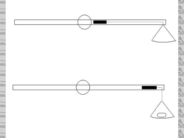

how about making the arm to the smal weight hollow and having a weight inside that can move. maybe you could connect it to the pan so that a small
object would move the weigth along the arm... something like this....
Dave

jambojeef
| posted on 1/2/06 at 02:31 PM |
How about this?
Its based on Dave's idea but the balance should go the other way when the weight is placed on the scales...
If the balance of weights is correct and stuff.....?
Geoff
cossey
| posted on 1/2/06 at 03:32 PM |
that would work if you had a spring going from the left of the weight to the arm that way the weight will only move by the right amount if carefully
setup.
