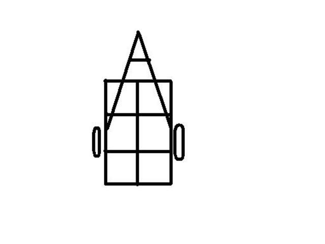

| posted on 18/10/06 at 07:43 PM |
50x50x3mm isnt strong enough to be the only backbone, it needs something extra. Not much extra, especially if you can use 4 uncut lengths from front
to back. I made mine into a box so that i could triangulate it.
  trailer4
As you can see, i didnt think to leave the 4 lengths uncut... Plus it has to be longer to make a box. I think the design around the draw bar is sound
though.

Danozeman
| posted on 18/10/06 at 08:15 PM |
Thats kinda my idea Joel just with the draw bar welded underneath.
Summit like this. Either with a straight bed or angle down a bit towards the back.

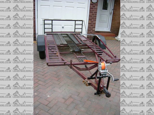

Wadders
| posted on 18/10/06 at 08:18 PM |
Hi Dan
at the moment she's buried under a scaffolding tower in my lock up, but if you can wait a week or so i'll dig her out and take some pics
and measurments. Its truly a cracking piece of design, dead easy to load/ unload the car, really manouverable too, even with the car on i can move the
thing around easily on my own. Dunno if the guy thought it out himself or made it from plans, but it works a treat. Solid beam axle (no suspension) i
thought it would bounce all over the place, but it tows like a dream, 80 plus behind my Sprinter and it never moves at all.

indykid
| posted on 18/10/06 at 08:37 PM |
is this the one wadders?
was taken a while ago when we took the garage down, so it may have been modded since.
just thought it'd save you digging it out if it wasn't necessary.
tom
indykid
| posted on 18/10/06 at 08:39 PM |
try again!

Wadders
| posted on 18/10/06 at 11:25 PM |
Hi Tom. thanks and, indeedy that be the one! believe me you saved me a lot of digging. no mods apart from a coat of paint
Dan the two big nuts at the front unscrew, and the bed tips up, hinged on the axle centre line, as you winch the car up it eventually gets to the tip
point, and the weight of the car brings the whole lot horizontal again. simple but effective.
P.S all the stuff in the middle is because the guy had trikes as well as grass cars.
