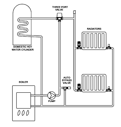

If it's a gravity system the two pipes feeding into the tank may have an airlock. Crack the joint on the top one and let it flow a bit of water
then tighten it back up, it has a red fibre washer so don't overdo it. It should have a breather pipe going up from it to the header tank in the
loft.
Simplistic diagram
thanks for hte diagram pete, but i have one question-
you say open the top valve and let it flow water, but isnt it meant to flow water from the central heating all the time? isnt that how its meant to
heat the water( which admittedly doesnt work)
bear in mind i know NOWT about plumbing...
cheers
It is supposed to heat by convection, the pipe going straight up is a vent pipe to vent air in the system and will be bent over at the top above your heating header tank in the loft. Another way to do it would be to get into the loft, stick the end of the vent pipe in your mouth and suck. The water will rise then find its own level again.
Ours is pumped heating, gravity hot water. It's an old system but is still efficient so I'm working on the principle that if it's not broke, don't replace it. It uses 22mm pipe to the coil in the hot water tank and heats it to the temperature set on the boiler thermostat. Even when the pump is not on the upstairs radiators get warm so don't underestimate the power of convection.
some further investigation-
there doesnt seem to be amy thermostat on the tank, except the one on the imersion heater....
neither of the middle pipes on the tank ever get hot, even when the central heating is on.
so, does that mean that the three port valve never switches over to this loop?
