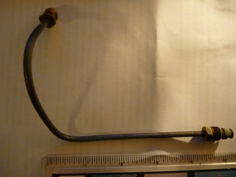

Our coal effect gas fire has been messing us about for a year or so now... we had an engineer in twice and both times he didnt fix it..
So I had a look at the weekend and found a badly pitted pipe that feeds the pilot light... it appears that it leaks when it gets hot so the pilot light goes out.. the gas instead burns an inch lower where it shouldnt be...This lets the thermocouple get cool which then means the fire goes out..
The bras collar on the pipe is corroded to the pipe...
I need to replace this entire assembly... none of the local places seem to be able to help..
Anyone know where I can get something like this made up?
It has two very weird ends....

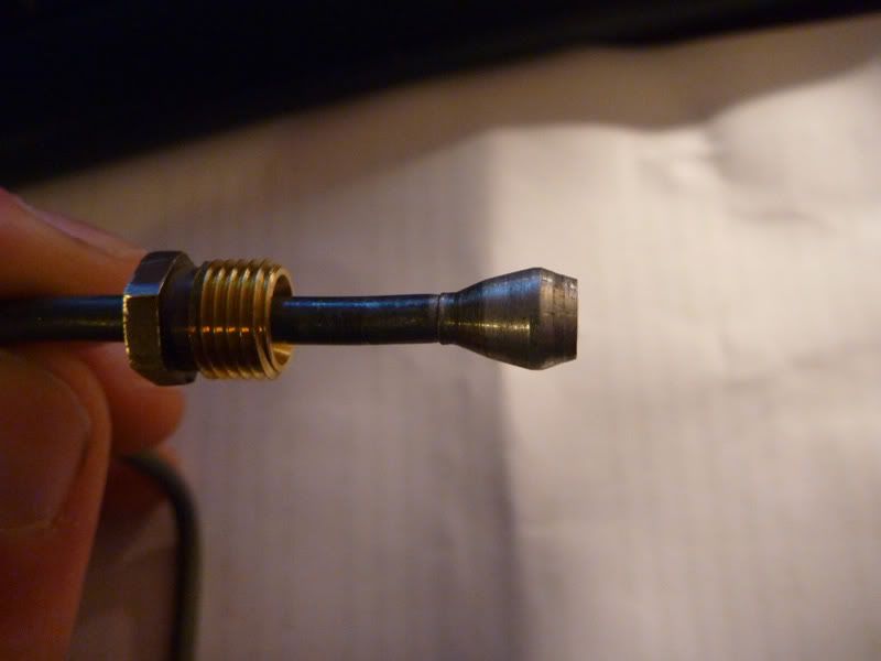

This end goes into the gas control box:

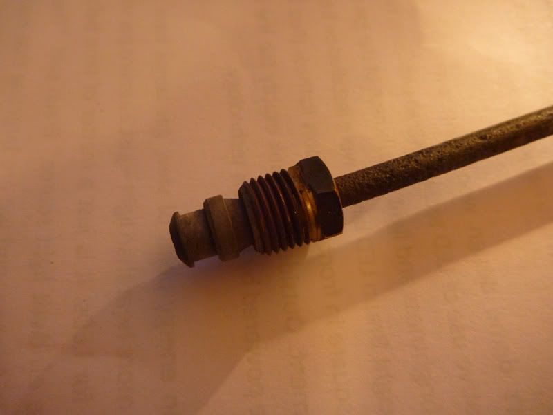

The pilot jet slots over the end of this and is then clamped inplace by doing up the brass collar in its housing... Note the pitting caused by heat..
Complete assembly looks like this:
Anyone have any ideas where I could get something like that?.... The local places just gave me the "health and safety" cack and didnt want to help.....

I would silver solder the old ends onto a new bit of copper pipe.

Interesting idea... the pipe isnt copper though.. its some steel or other?
And what temperature does silver solder melt at? The pipe feeding the pilot light must get pretty damn hot!

What make is the fire? We had a similar problem with a Straxgas, not corroded just a problem with the thermocoupler. I ordered the part from the manufacturer and there was no problem supplying.
tegwin
posted on 2/2/10 at 10:41 PM Reply With Quote
907... if silver solder melts at 660C... what temperature will the steel on the fire get to around the pilot light?
I have no idea what make the fire is... someone has obviously made it from parts as a custom fit job for an old coal grate.....
Its a very old fire! lol.. (circa 20-30 years)

I can't say what temp yours gets to but the nozzles on my propane torch are silver soldered.
Spit on your fingers and then grab the pipe.
Measure the scream volume with a db meter and multiply by 4.

Obviousley a new pipe from the manufacturer or maybe somewhere on the internet if you type the make and model in a search engine, but if not:
Try putting it back together with Gas Paste smeared on the olives or flared ends or GAS PTFE if really desperate (obviousley being careful not to obstruct then ends of the pipe).
It might be enough to get it to seal as the Gas is a very low pressures.
Thats Disgraceful whoever left that fault.. they obviously take the time to confirmdeny your observations... or even spray the pipe with leak detector spray!
(which would also be the best way to check if the gas paste or ptfe has worked)

To be honest Tegwin, if the fire is that old I'd be thinking of a new one.
The spreader grill and coals must be getting a bit crumbly by now and you could be throwing good money after bad.

The rest of the fire is in perfect working order, its just this one piece thats letting it down...
Will have to see if I can get some gas paste from somewhere and give it a go... its not going to risk damange to anything or anyone, so worth a try.
Any idea where to buy the gas paste? A quick search on screwfix brings up nothing atall...
Failing that we may have to look at alternative solutions..

British standards state that you cannot have soldered joints in the area of the fire, there is a set distance but i can't remember what it is.
What make is the fire? Most manufacturers will be able to supply replacements.

The stuff we use is made by ROCOL, but looking on Plumb Centers website its about £17 a tin!
Here's some for sale on Ebay, so you've an idea of what it looks like:
Ebay: Gas Paste
There may be others you can use like Boss White, or Hawk etc but its best to check on the back its for use on Gas, as some pastes dry out and crumblle over time, where Gas paste doesn't.
Just found this on B&Q's website for £7.98
Jet Lube V2 Jointing Compound

Hopefully the Pase will have worked but if not it might be possible to get something like this to fit.
http://cgi.ebay.co.uk/Potterton-6-mm-Pilot-tube-kit-Honeywell-fixings-700723_W0QQitemZ360217273664QQcmdZViewItemQQptZUK_Home_Garden_Hearing_Cooling_Ai r?hash=item53de9f6540
That also looks a good ebay shop for other spares. I hadn't suggested it before because the end that goes into the Piot looks quite unusual.. but something might fit out of the kit, there quite universal, they do them in 4mm pipe aswell.

I find it interesting that in the ebay link (^^^) kit they use aluminium pipe.
Ally has the same melting point as silver solder.
