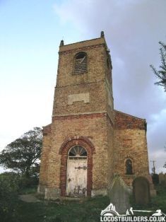

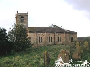

Right, there may be more/different plans afoot! I know I should stop looking at old buildings for sale, but I just can't help myself! I've spotted a nice 1801 built church near Kingston-upon-Hull. A local surveying/architect firm reckons it should get planning permission for change of use, but I appreciate this isn't a certainty. Any one able to give me a rough idea of what is involved with converting such a building to residential use? Is it generally a case of slapping in a kitchen, bathroom etc and away you go? The structure is supposed to be sound, and is wind and water tight, so shouldn't need much/anything in the way of structural works, apart from that required to put a second floor/mezzanine in. Also, any one know of a rough costing per sq/m for this kind of work at all? I'd be looking to do most of the work myself, where possible, so that should reduce things a fair bit. I wouldn't be too fussed about time scales, but it would need to be liveable within a few weeks (to stop the boss complaining), if that makes any difference to things.

Oh, it looks like this

And this

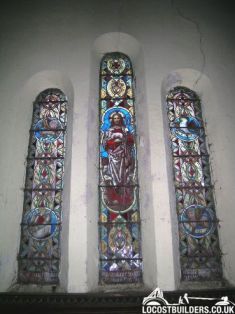

And hopefully with this window
Oh, how the heck do you persuade it to put more than 1 pic in a post?
