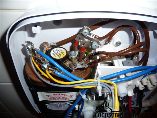

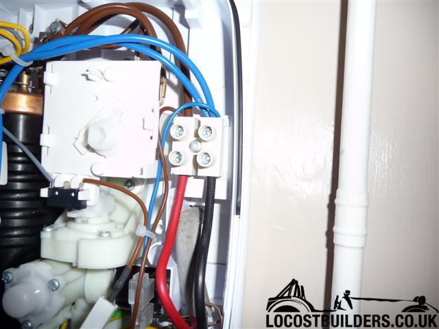

So tonight, I've taken the cover off, to find a set of melty wires inside. The wires from the mains to the chock block look ok:-

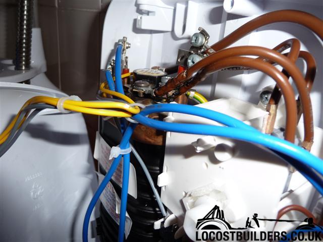

But the big brown wires inside at the top look like they've had it:-
They were stuck to the little yellow one (which goes to the light on the front), which has also melted. The brown one and the yellow one might have
been stuck together, but they've come loose when I've removed the cover:-

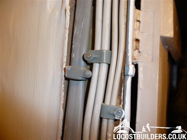

I can't tell how big the supply cable is just from looking at it, and there are no markings on it. But here is a photo of the cable (on the
right) next to the ring main for upstairs and the lighting ring for upstairs:-
(probably not that helpful as it is lying flat and the other cables are on edge!)

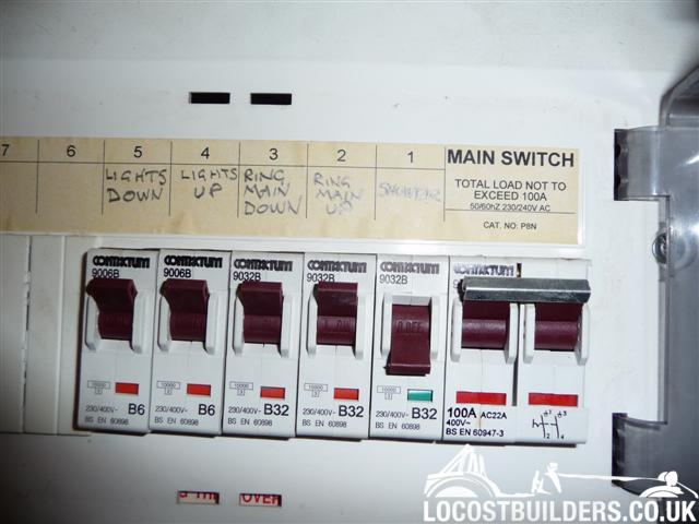

Finally my fuse board, showing the separate fuse for the shower, which hasn't tripped yet (either this time or last time the shower went:-

what rating is the shower in kw? the cable wil have csa on somewhere mate. pull a clip off and look on the back. i assume you meant the cable to the
left and not the right? get back to me with the info and will try to help from there. am an electrician by the way

But I wouldn't have thought that the supply cable was an issue, nor it seems are the thinner blue wires connected to the neutral.
The problem seems to be the fat brown wires connected to live and going to the heater. It seems to have got hot enough to melt the insulation in
contact with the yellow wire (presumably making the smell)

the supply cable definately has not caused this problem,but if the shower is rated at a higher rating than the supply cable can deal with it could be
dangerous. the cable looks like a 6.0mm which is fine on a 32 amp mcb. a loose connection on the internal browns to the heater or the internal browns
being trapped against the hot pipe look more like the problem

Looking at the colour of the screw on the connection of the over heat stat i would say that either it is loose or there is a bad connection from the
screw to the cables. This has caused excessive current to be drawn and so started to melt the insulation of the cables. It would only trip if went to
earth or Neutral or was drawing more current than the trip is rated at. Take it back i say.
westf27
| posted on 23/2/09 at 07:37 PM |
thats just a poor connection on the live connection to heater.Cut back brown wires till the conductor is bright copper and re terminate,clean heater
connection area and secure.

Pulled the whole length off supply cable loose. No markings other than BASEC BS6009 on it, either side.
Had wiggle of the brown wires, the screw that is brown (compared to the rest of them) is loose and the wires can wiggle but that could be due to the
build up of heat / cooling?

westf27 is spot on i think mate.its the only place it can be really.it looks quite servere tho so its a good job you found it when you did. if you do
re terminate the wires make sure they are very tight, (including the internal factory ones,which yours is)

everything your end fine, the brown wires have probably had a slightly loose connection which just snowballs overtime, as the more it heats and cools,
the more corroded it gets, the looser it gets, so the more it heats and cools, until eventually it start to smell funky.
