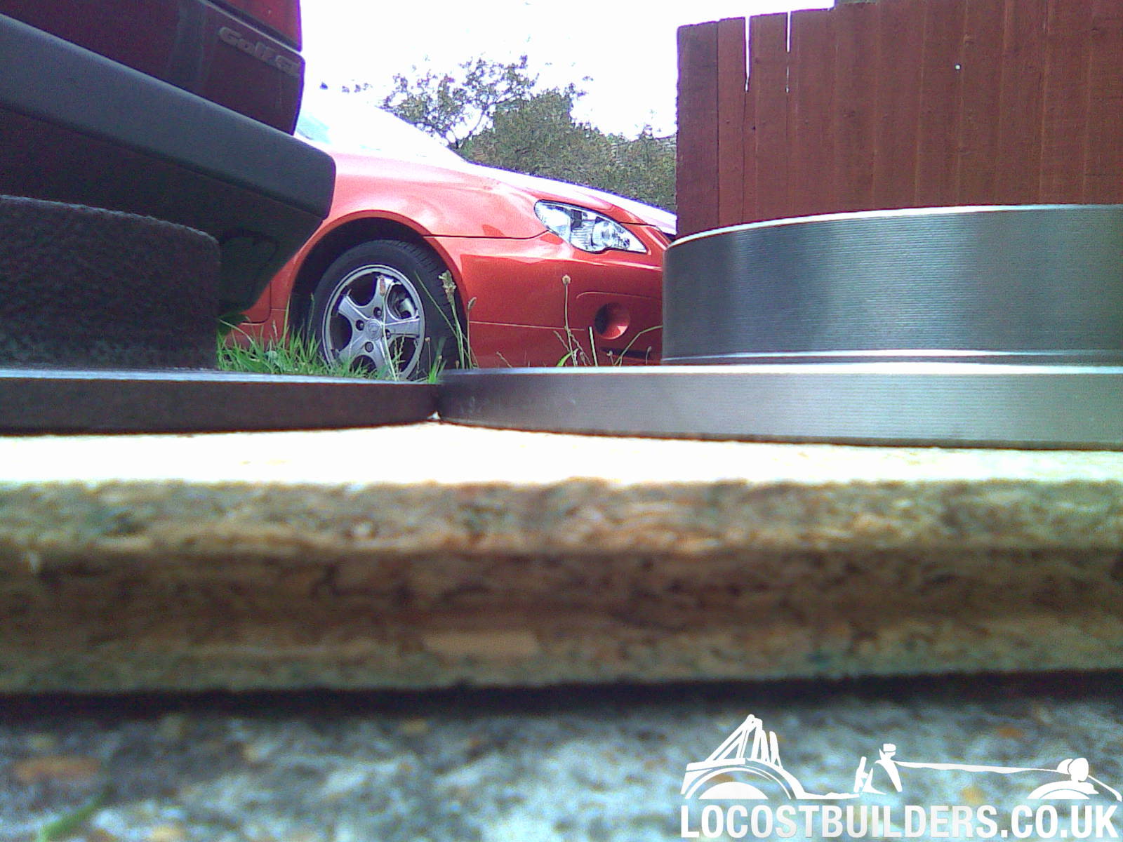

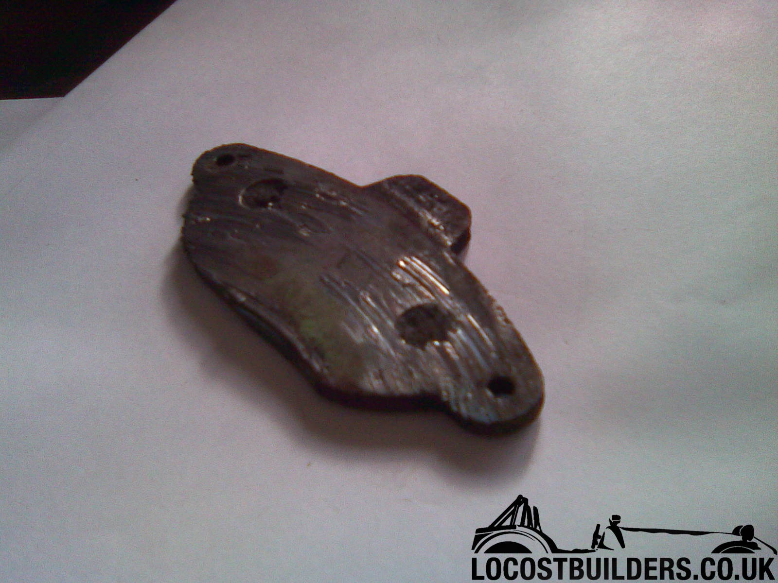

posted on 22/7/09 at 06:11 PM Reply With Quote
Well I think that as BT said, the reason the pad had slipped was the combination on nothing left of the pad:
Worn Pad Linky
And a somewhat less than optimum disc! Somewhat smaller than it should it I guess!
New vs. old disc Linky
Maybe my sister's just trying to garantee her inheritance!
