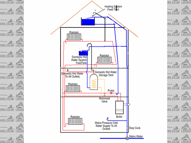

So this is what we had:-
  Central Heating Before
Initially the plumber said that the pump would just pump the water round the pipes to the new rads........
That obviously didn't work, so he's now relocated the central heating header tank, from the loft above existing bathroom, into the void
above the new bedroom (right in the top of the roof).

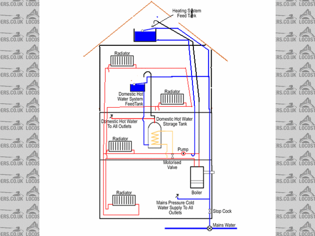

So this is what we have now:-
  Central Heating Now
(Excuse the crapness of my paint drawing, but I really can't be arsed to CAD it all up!)
So the tank is as high as it will go. The 22mm vent, 22mm overflow and the 15mm return and cold water supplies have all been extended from their
positions in the space above the old bedroom, past the new rooms and up into the roof.
I've fired the central heating up tonight, and it's not working right. Basically the rads on the ground floor heat up OK, as does the one
in the old bathroom. The one in the bedroom next door to the bathroom gets tepid and the one in the front 1st floor bedroom is stone cold.
The rads in the attic are all stone cold too.
However the 22mm vent from the airing cupboard up to the tank in the very top of the house is red hot. And water is flowing straight up there and
emptying into the tank. From there I assume it's going back down the return as the level isn't getting any higher and it isn't going
down the overflow.
The central heating pump is on 1 of 3 (the lowest setting). If I turn the pump up to 3, all that happens is the amount of water coming out the vent
into the tank increases in volume and temp!
So, it seems to me that the water in the central heating circuit is taking the route of least resistance and shooting up the 22mm pipe, rather than
circulating through all the 15mm and the rads.

No you can't move your vent pipe as shown in the third diagram. It should be within six inches of the 15mm feed into the system from the header
tank and both should be within a few feet of the pump inlet.
If you consider how the system works, the pump forces water around the system. All the water that is pumped by the pump is replaced by water returning
from the radiators via the boiler. There should be no flow in the feed or vent pipes. The feed pipe should allow expansion of the hot water (and any
air) to push a little water back into the tank and replace it as it cools and contracts. The vent is there to allow air to escape from the system and
water/steam in the event of a blocked feed and boiling water, thus preventing a steam explosion. As the vent is on the suction side of the pump there
should be no pressure to force water to take that route.
Just a silly thought, has the pump been removed for any reason? It may have been replaced pumping in the wrong direction.
Just looked at you diagrams again and noticed something - it may just be your drawing though. The original system is shown as fully pumped (all
radiators are fed from one pipe and return through another), but the new section is shown as single piped (both connections on a radiator are to the
same pipe and flow within the raidiator relies on different temperature water having different densities).

It looks like the flow is going through the hot water circuit, which has much less resistance than the radiator circuit. If your drawing is correct
that is the only way it would pump up the vent and into the header tank.
Firstly I suggest you insert a gate valve in your hot water circuit to throttle it down.
Then, with the hot water circuit shut off by your motorised valve (i.e set to heating only), balance the radiators to get adequate flow through the
topmost radiators. Start by fully opening both the balancing (not normally adjustable) and the hand adjustable valves to all the radiators. Then
follow the balancing procedure as per...
http://diydata.com/projects/centralheating/balancing/radiator_balancing.php
Once that is done, set your motorised valve to feed both heating and hot water. Then gradually close your heating circuit gate valve until water stops
coming out of the vent pipe. Then close the valve another quarter turn or so to make sure you have no unwanted flow up the vent pipe.
Don't be tempted to relocate or put any restriction in the vent pipe.
Hope that helps, cheers R
