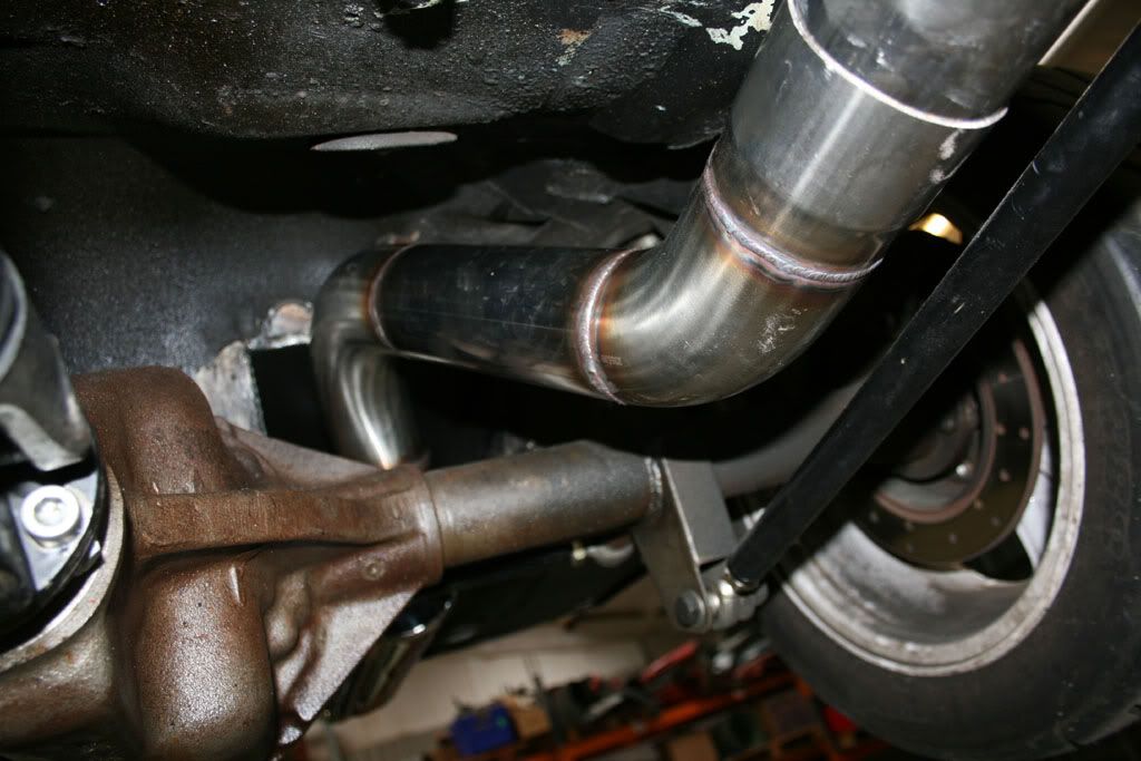

I fabricated a full stainless steel 3" bore exhaust system from turbo to tailpipe last week for it, and its definitely quicker now (was only on 2.25"
It now actually uses the exhaust tunnel I fabricated last year!!!

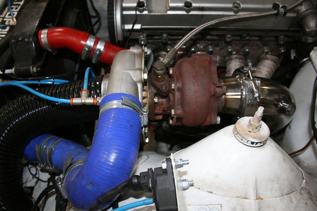

Few not great piccies of the exhaust and general under car murkiness (lots of oil leaking out, we've discovered that the omega box breather isn't too great, now its got a piped breather to a gearbox catch tank, only way we managed to stop it peeing out! )
all a bit flipping tight under there!!
slots nicely into the tunnel I made last year!
over axle jiggery pokery!
