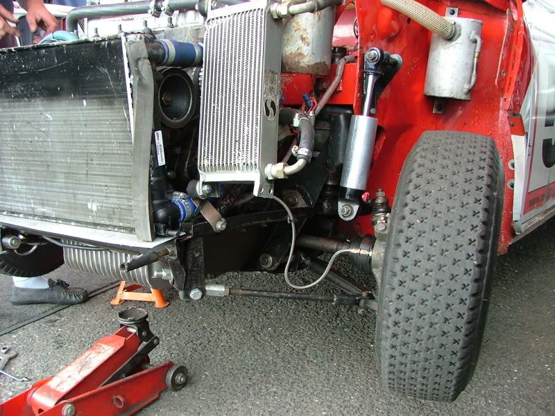

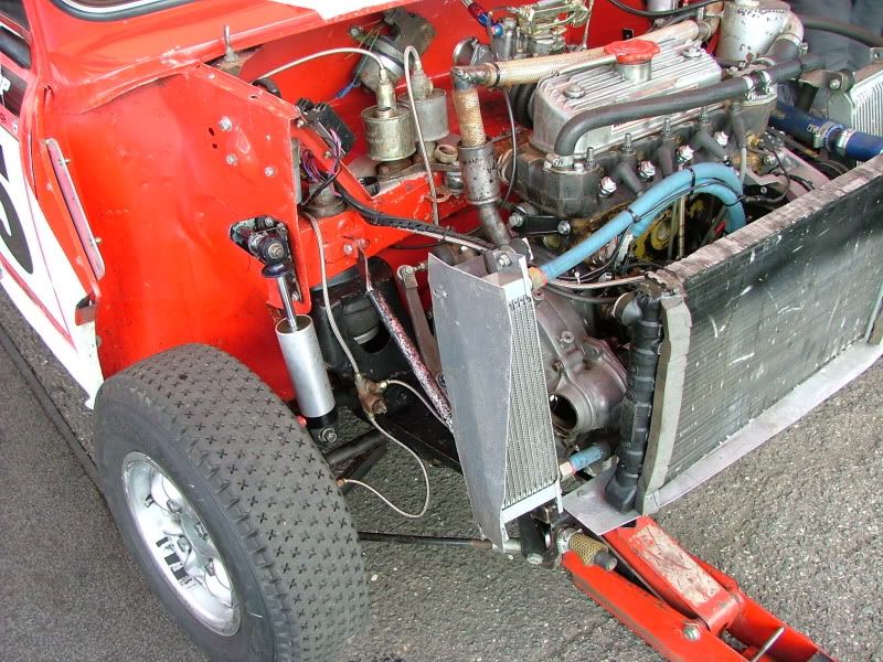

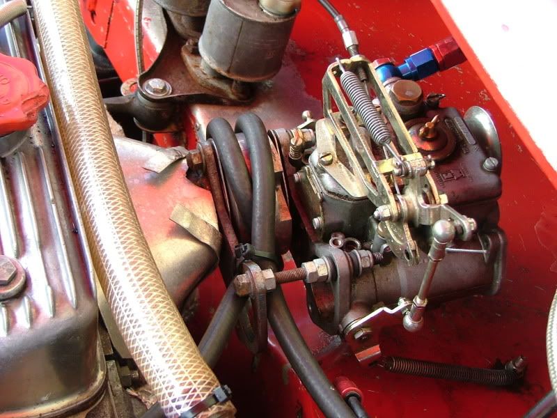

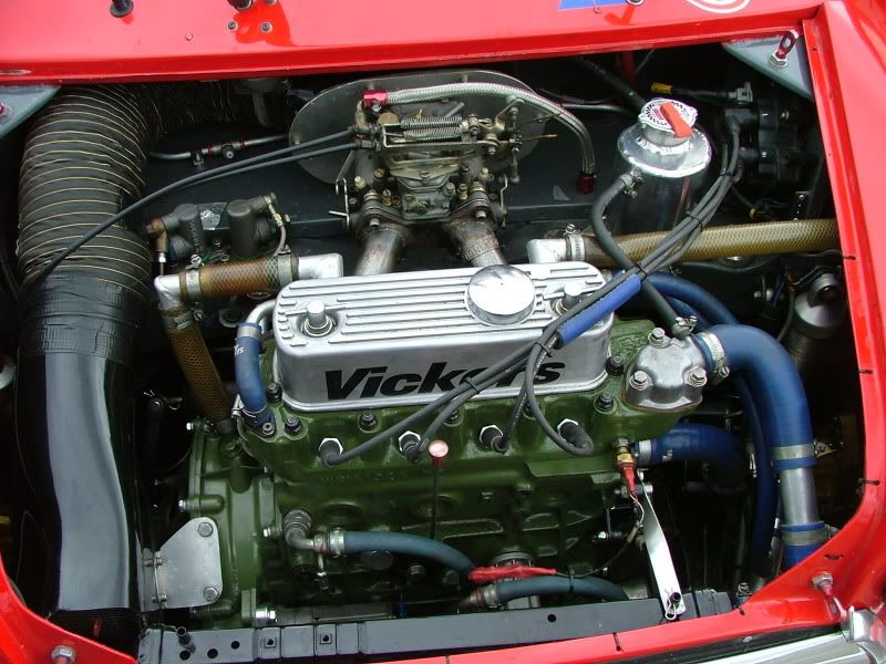

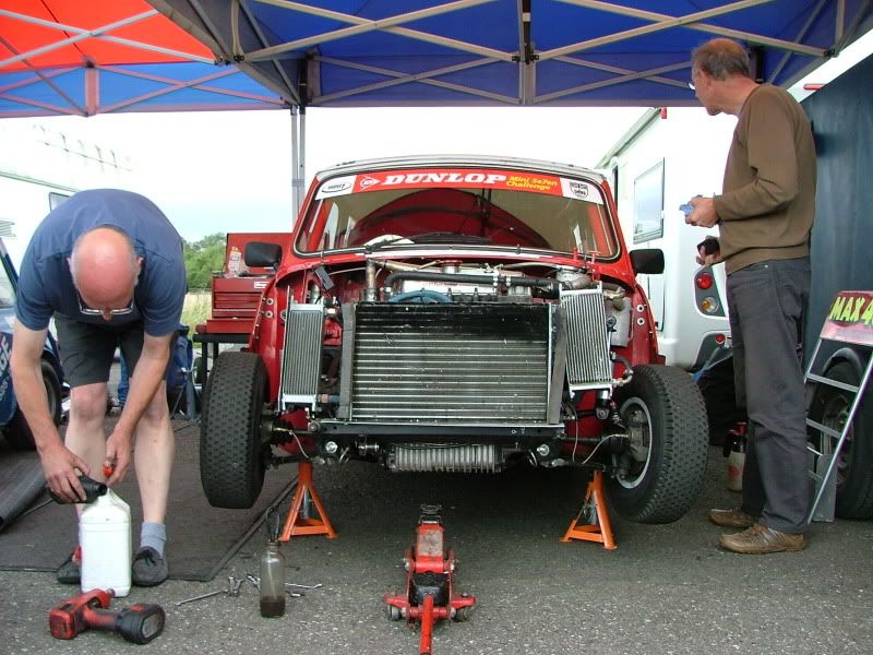

Darren, the racer's choice would appear to be a weber plus megajolt? (see pic) Dont think they have to worry about MOTs though..
I took these pics with you in mind a few weeks back. There were loads of Mini se7ens and Miglia at Croft.
If nowt else, it's a bit of inspiration.
The single carb furmula (Mini se7en?)appear to use half a weber.

Brace bars already fitted, probs bought items but look terrible. Am thinking of remaking them, along the lines of locost arms - ie bar with round tube at each end and poly bushes, U brackets welded to bulkhead and subframe. Maybe even make them adjustable length. Ive seen some that were rose jointed in this months mini World. See Andy's pics above too - the red car has a different arrangement.
