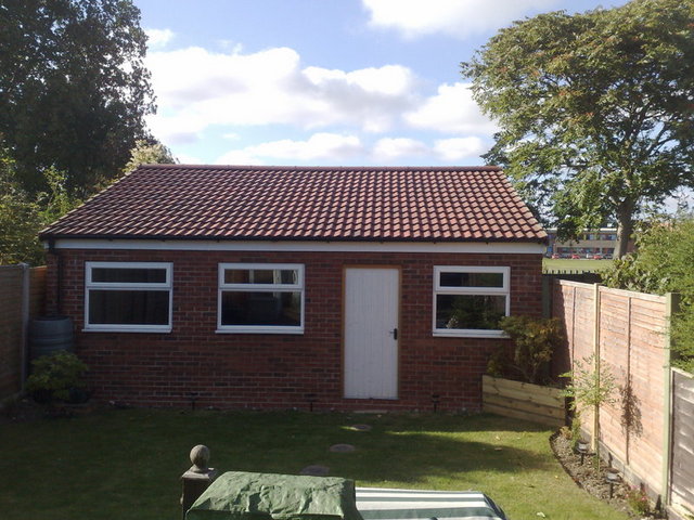

richardR1
posted on 14/9/09 at 04:29 PM |
Pic of mine
I used dry ridge system and dry verge system, bit more expensive but no messing with sand and cement so don't have to worry about the weather and
won't weather as mortar does.
MK Owners Club Member 1015
