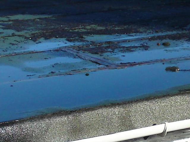

cheers ray, but i really need to stop the water getting in, rather than catching if after it has. its rain water, rather than condensation
heres the puddle that causes it
you can see a past attempt to pour fastglas resin over middle of it, which worked for about 2 years, but has lifted now
you don't want to see what inside is like
[Edited on 2/2/10 by blakep82]

hmm, doesn't look promising.. lol

B&Q did (hopefully still do) something like 'bitumen roofing tar' in a tube.
It sorted out the leak on my old dears garage roof, but going by the picture yours is a bit more serious
Didn't cost that much either iirc.
