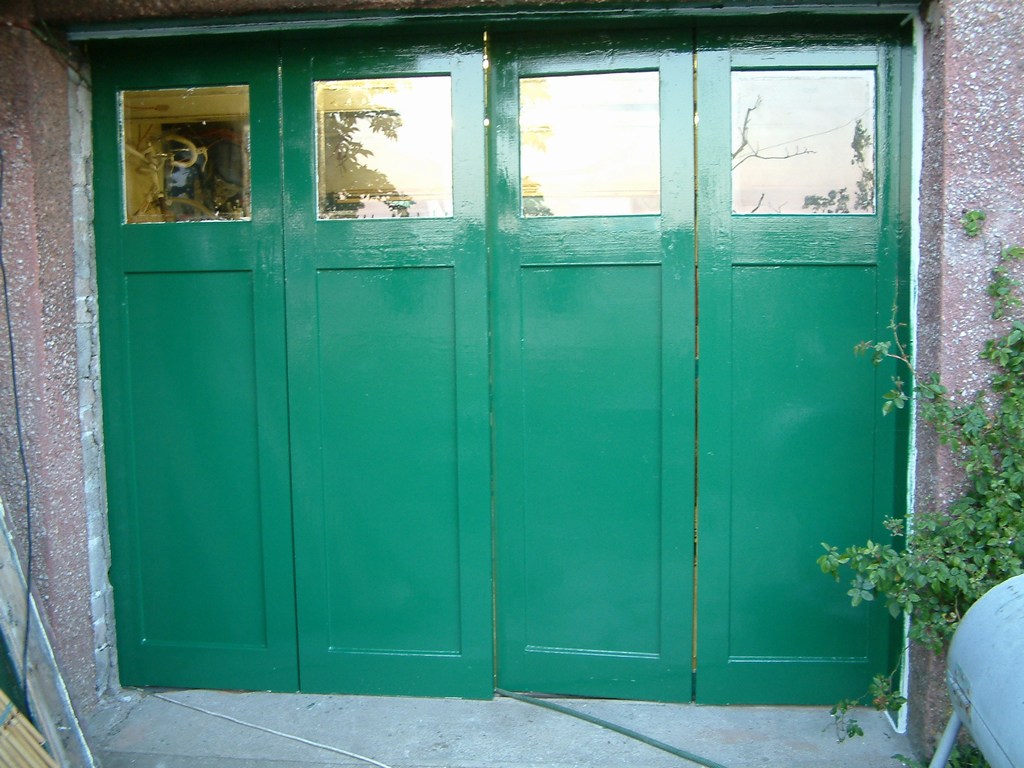

MikeRJ
posted on 20/3/10 at 12:33 PM Reply With Quote
Originally posted by ChrisW
Now, I'm no carpenter, so any kind of clever joint is out of the question. So, I was wondering about bolting the corners like this:
I'm not a carpenter either, though I really enjoy woodwork. About 6 years ago I made these doors for my basement with mortice and tenon joints, and it wasn't too bad a job. I used a router to make both the mortices and the tenons, and since I had so many to make I knocked up a couple of jigs out of scrap wood so it only took a few minutes for each joint.
The panels are made from marine ply, fitted into a slot routed into the frame. The frame was made from pressure treated wood sold for decking frames etc. I wanted to make them from hardwood, but I was a bit skint at the time.
[Edited on 20/3/10 by MikeRJ]
