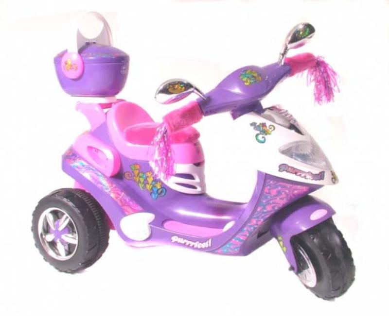

I was working at my grandsons trike this weekend. The only way to charge the battery was to remove the seat, split the cable and plug the lead from the power supply. I got a Bulgin plug and socket and mounted the socket on the rear of the trike and the plug onto the power supply lead. Makes it easier to connect the charger without taking the seat off.
His trike uses the same battery as yours, a 6V 4.5Ah. I am getting a second battery for this trike to enable him to run it longer between charges.
Regarding putting in a larger power battery, IMHO this will not be good for the motor. These motors are designed to run at 6V that is why they supply them with a 6V battery. What I'm doing to my grandsons trike is not increasing the power to the motor, it's just making the battery last longer.
Hope this helps
Tom
