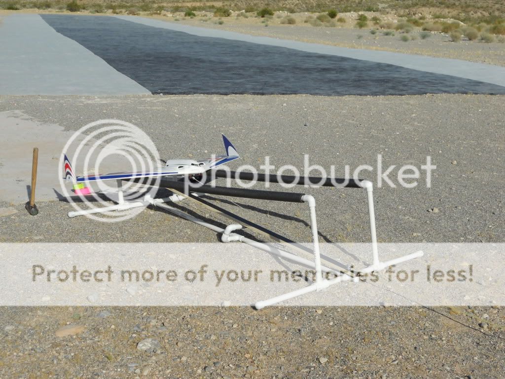

Or you need a peddal launcher
LINKY
BenB
posted on 29/7/10 at 06:18 PM Reply With Quote
Originally posted by rf900rush
Do you use elevon mixing etc.
If not could you use the heli idle up function.
LINKY
Yes, that's what I wondered about. Getting a V-tail mixer and then having it as a Heli! Otherwise a launch ramp might be an idea. The other thing I did think about is having a microswitch on the launch grip that I've got under the plane. When you press the switch it cuts off the power to the motor. Then as I let go off the plane the motor comes on
