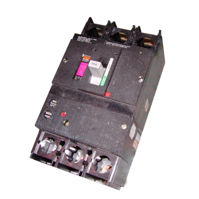

For things of that loading I use boards like this:
that take breakers that look similar to this:
Or feed direct off our 1600A busbar.
You will need the incomer to the building removed to do it so yeah it will prob cost a bit. Sorry I can't even guess at a price as I'm not
self employed/contracting.
