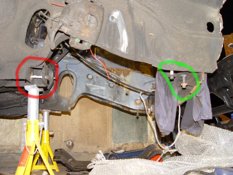

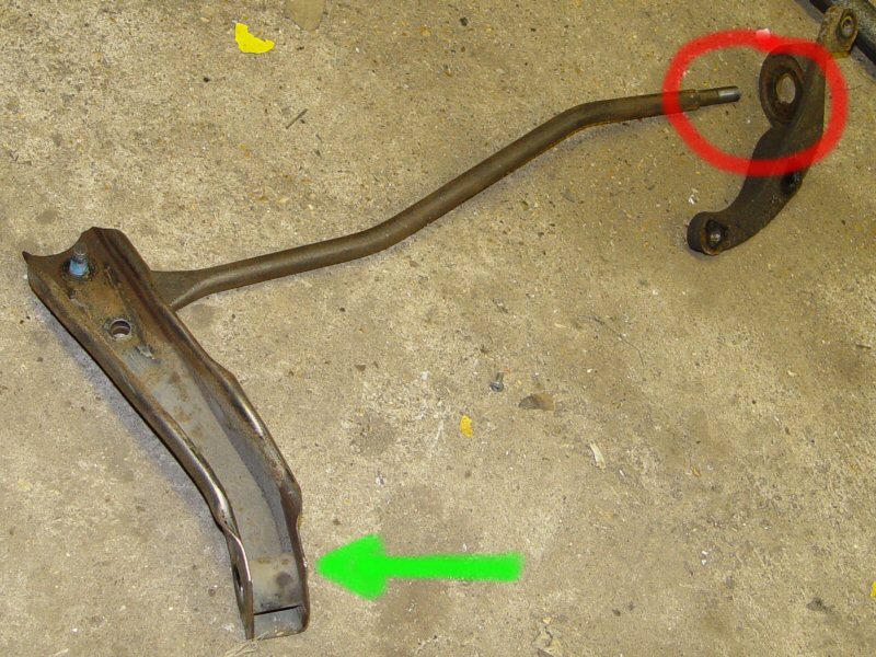

| posted on 22/6/04 at 05:47 PM |
Two photos here...
http://chrisw.net/stuff/fez_suspension/1.jpg
http://chrisw.net/stuff/fez_suspension/2.jpg
The first one is the car itself. The bush you are talking about (I think) attaches to the bracket circled in red. The ARB bracket, into which the
ARB bush sits, bolts on to the bolts circled in green.
The second pic is the assembly itself although I've just realised the ARB bracket is from the wrong side. The arrow is where your bush needs to
go and the bit circled in red is where the ARB bush bolts on, either side of the bracket. The lower balljoint connects where the ARB and the lower
arm join - as you can see, one bolt is pressed into the ARB.
Hope that helps! As I said above, the lower spec cars didn't have ARBs so I don't know how different that will make it. Your Ghia will
most likely have them but it's not a definate.
Chris
My gaff my rules
locoboy
| posted on 23/6/04 at 12:45 PM |
Cheers Chris,
had a quick lok at the car last night in the rain! Its the front bush thats buggered the one just behind the valance, got that part this lunchtime but
it is a far smaller item than the original that is on the car. The one currently on the car is maybe about 60mm diameter and the new one is maybe only
about 40mm. so its just one rubber donut either side of the bracket then?
So when you say one bolt is pressed into the arb, you mean it wont come out so one will and the other wont? is it the outer most one?
I guess i had better not go at it with the hammer then!
[Edited on 23/6/04 by colmaccoll]
Locoboy
ChrisW
| posted on 23/6/04 at 01:04 PM |
Col
It's the outer bolt on the ARB that is pressed in. Once you've undone the ball joint from the lower arm all will become clear!
When you dismantle the ARB bush there's a plastic washer type thing that sits in the bracket to hold everything central. Both of mine were
knackered and I've not decided whether they're needed yet but probably best to keep an eye out for it!
There's two rubber 'donuts', two big washers, and a metal tube in the middle. Once you get it all apart it should be fairly self
explanatory!
Chris
My gaff my rules
