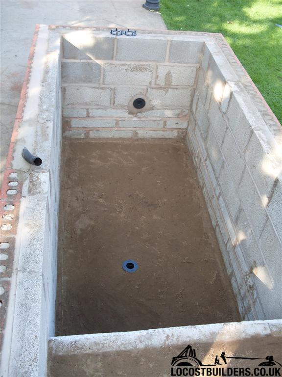

Originally posted by snippy
I`ve been told that keeping your pump running in cold weather just sucks the warmer water from the bottom of the pond and therefore lowers the temperature in the bottom of the pond which is where the fish will hide to keep warmer. I have previously had my pump running all previous winters but due to these extreme temperatures we are having I`ve turned it off. I switch it on again if it`s gets near freezing to airate the water.
You just really don`t know what to do for the best. I like the polystyrene cube idea though!
Yes, quite right - forgotten about that! - on advice, I built two outlets to the pump system - one from the bottom centre and one from halfway up the side for exactly that reason. - See pic
