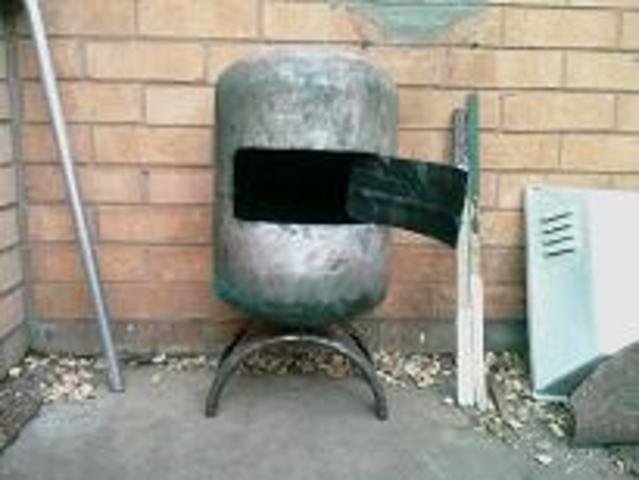

Here's a picture of mine during building.
Basically, I opened the tap and let any excess off and then unscrewed the tap at the end (this can be very tight and I had to saw it off another). I then tip the bottle and leave it for a day or two and then fill it with water to force anything else out and then leave again for a couple of days. Then comes the scary part, I lit a match and put it over the top and dropped it. Queue a really scary 1 second WHOOSH then you're done.
I cut the base ring off the bottom and then cut that in half and used it for the legs, carefully cut the door with a slitting disc in the grinder, though I wished i had access to a plasma cutter to keep it neater, then I cut a hole in the top around where the tap was to act as a flue and I put a small collar ring around this made from some flat steel.
I have since cut a rectangle in the door piece and welded on some mesh then welded the door back on with a brass latch rivetted on the other side and after the first burn, the paint comes off, all rubber like. A razzing over with a wire attachment in a drill to clean it all up and then I used etch primer and hi temp black stove paint and you're away.
TBH I am thinking of drilling a couple of small holes in the bottom corners to get a bit more air underneath and help burning but it works fine.
