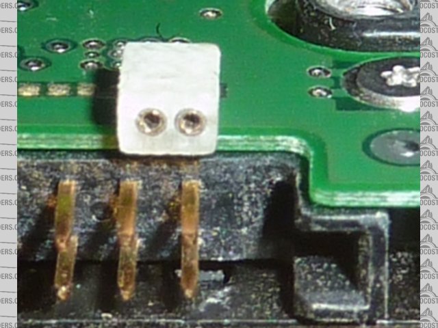

Hi,
Just been repairing my model heli and made a booboo - the power connector for the main motor on the PCB wasn't flush so was able to wobble. When I plugged the motor back in, it wobbled a bit too far and broke it's leg.
Don't really want to splash out £40-50 for a PCB when it's a component that costs pence that's the problem...
Worse case at the moment is I solder the motor leads direct to the PCB...but would rather keep the ability to unplug it...
Anyone know a source for teeny tiny pcb plugs like the white one below...?

PS For scale, the other set of pins are the data connectors of an old 2.5in laptop drive...
PPS it's an E-Flite mSR...

I'd solder the leads on to the PCB then use connector further down on the wires to still disconnect it if you need too. A standard servo extension lead would be my first call, just remove the signal wire to leave the two power supply ones
what you need is a servo wire like this but take off the orange or white wire, cut the cable in half and then plug each connector in to itself -

I'd solder it directly and if I ever needed to replace the motor just cut + splice the wires (to avoid having to muck around with the PCB again).

Weight would be my piggest concern...these plugs are 3-4x the size...
posted on 4/4/11 at 09:31 PM Reply With Quote
yeah but the plugs are almost hollow and weigh nothing even for a indoor heli
