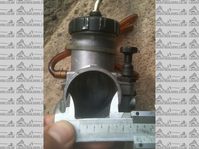

Bugger! They arrived yesterday and despite the assurances from the vendor that they are 45mm carbs, it turns our that the 45mm relates to the OD. The ID is 40mm and therefore far too small.
So back to my original Q... are carb / throttle bodies generally measure by the ID of the 'engine' inlet side?
Cheers.
the short answer is yes
