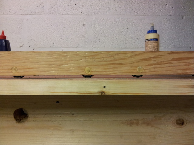

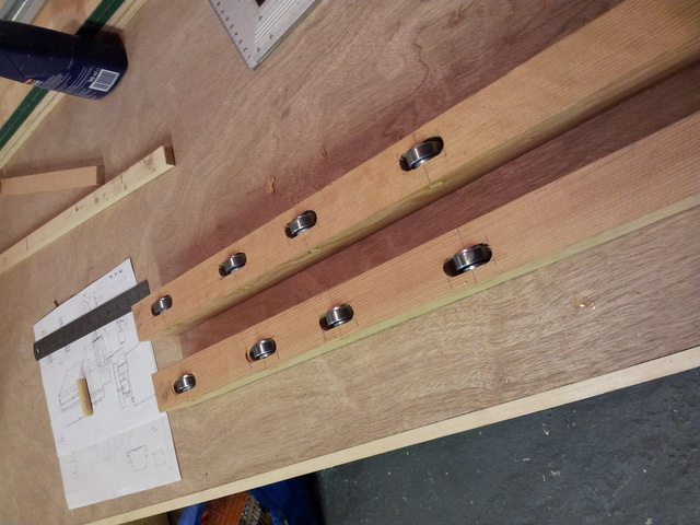

I am currently in the middle of making my workbench in the garage.
I wanted to have some big drawers and given their size will be heavy when full, I wanted a fair amount of extension but couldn't justify the £60
odd quid per set of ballbearing 75% extension drawer sliders so I made my own home brew effort.
They are beefy enough to extend far enough and still manage the weight. They run on some angle which is screwed to the table legs.
The drawer is 4ft wide, 2ft6 back to front and 12 inches deep.
Bearings are 32mm diameter and 10mm wide with a centre bore of 12mm, set into 50x50mm timber.
  drawer runner 3
  drawer runner 2
  Drawer runner 1
Locoboy
