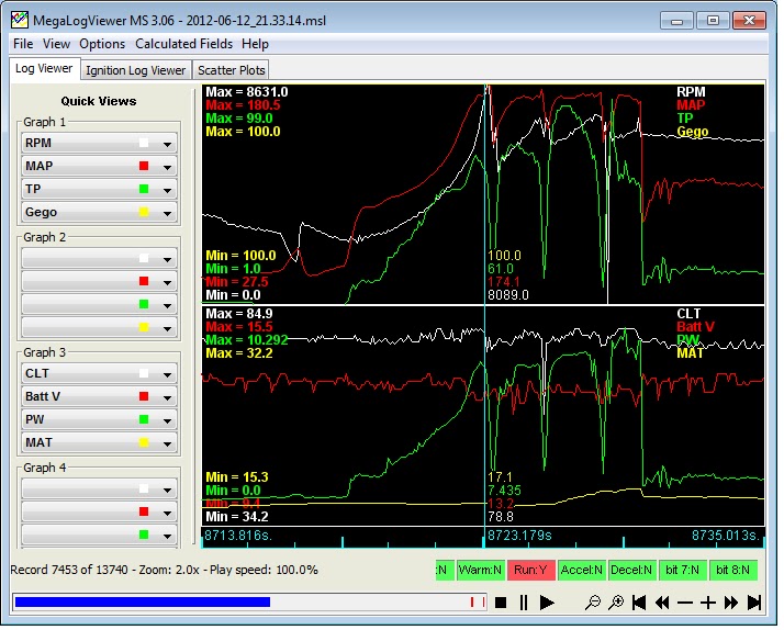

Here is a datalog from my gsxr1100 engined. Boost controlled to stay below about 12psi.
Not sure whether 16t is optimal if you are running low boost on a 900cc bike engine.
