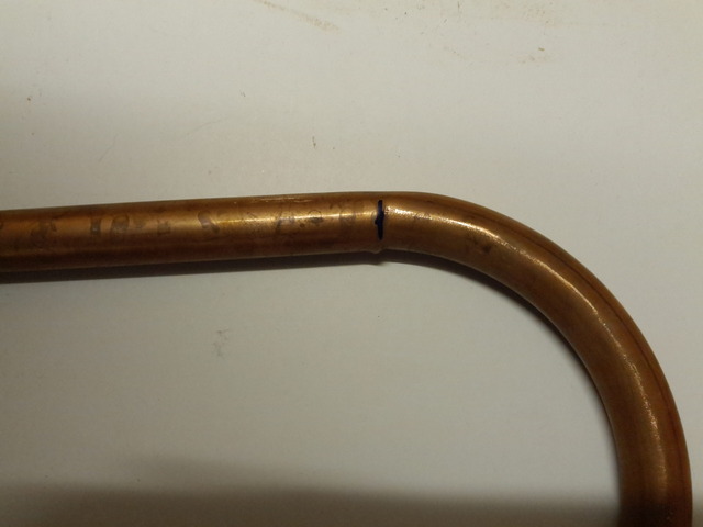

So I'm turning out to be a far less successful bender than I'd hoped!
I'm trying to put 90° bends in 22mm copper tube. I've perfectly happily Done loads of 15mm. It a new bender so nothing should be worn
out.
However after the first 22mm attempt which was successful the pipe is now kinking every time.
[img]
  kinked1
[/img]
[img]
  Kinked3
[/img]
It always happens at the start of the bend, it's like the end of the tube is being pulled towards and into the former.
I've tried lubing the former and the slider, i've lubed the wheels so they spin freely. I've cleaned the former and slider and pipe
with scotch pad. I've even bought new pipe in case the original had got old and 'brittle' or something. Oh, and I've tried
mounting it both ways up in the workmate!
I've done it loads with 15mm but never with 22mm before... What the hell am I doing wrongly?

Also, if I just say 'fek it' and use the kinked pipe, is it going to be a weak spot that's going to leak?

Copper tube comes in different grades, you have a thin cheap grade by the look of it which buckles and kinks.
Just look at copper pulled out of an old building, difference is night and day.
Andy S
| posted on 28/9/14 at 07:40 PM |
Could be the tube is not fully annealed or its has started to age harden - Cheaper tube and thinner wall tube also causes problems - could drop a
spring in it?

Will one of those plumbers springs work whilst bending it in the bender?

Fill tube with water or oil, crimp ends, then try again
Tightly packed sand may work, although may be difficult to get rid of.

I ought to follow this up in case anyone else has the same problem...
Short version:
Turns out the bolt holding the curved former was slightly loose.... the former was then moving as the arm was pulled and 'folding' the
pipe around the sharp end of the former. Bolt tightened, problem solved!
Longer version:
I had the day off work so I waited till the plumber got there in the end and asked him to have a go with my bender. Same problem.
