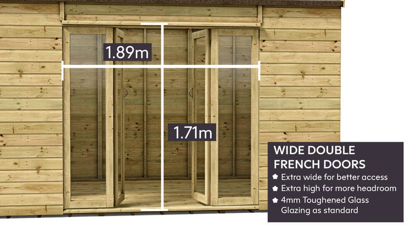

My gf has a summerhouse that she uses as an office. Its a generic style similar to
THIS.
It has the 4 door set up but as you can see from the dimensions
HERE are not very big or an off the shelf size.
The problem we have is the door taking on moisture and swelling, making closing it almost impossible.
Is there an easy way to prevent this? The slave doors....1 and 4 as you look at it, have been secured to the building so only doors 2 and 3 open.
In fairness, the door doesnt get hit much with rain water as we fitted guttering and painted with quality waterproof paint so presume its the damp and
moist air as its only recently started to happen.
Any locost ideas?

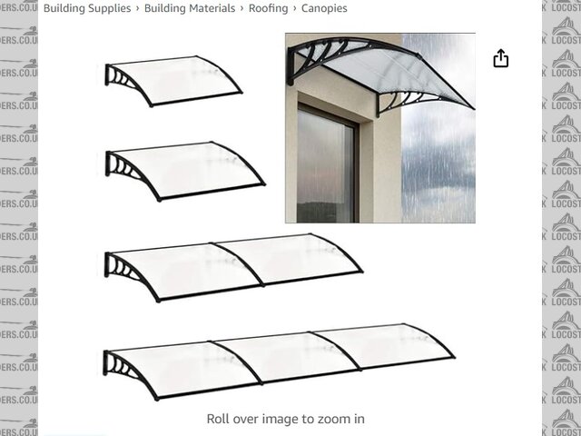

I got one of these for over my back door which was getting hammered by the weather. It's amazing how effective it is at keeping the door dry and
has shrugged off the storms lately even though it's on the worst side. If your door faces the prevailing wind it won't be getting sufficient
time to dry off before being soaked again, even if it looks dry. I got mine from amazon for about £30.
[Edited on 2/11/23 by Mr Whippy]
