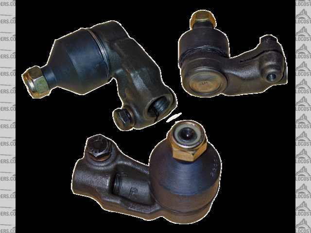

I've been trying to make my Cavalier MOT friendly over the last few days and now need to replace the tie rod ends. Vauxhall are obviously quite
stupid and have not actually made any provisions in their design to allow them to be removed easily. The rod ends on the car are identical to the one
shown below with the exception of a little rust and an immovable urge to remain part of the car. Has anyone experienced and overcome this
foolhardiness? Any help greatly appreciated.

| posted on 26/3/05 at 06:38 PM |
Take the traqck rod off the car , single bolt and spring clip at rack end , plenty of penetrating oil and probably heat will shift them .count the
number of turns you unscrew end , make sure you free off the adjustor {the double ended bolt} in the track rod . When every thing is freed off
reassemble counting number of turns, LIGHTLY nip up clamp bolts, repeat for other side in required. Get tracking set, should be able to centralize
steering wheel by adjusting track rods when adfjusting tracking, Something like a supertracker is good for this but can be set on old optical gauges
with a bit of patience. H.T.H. Rusty.

| posted on 28/3/05 at 01:49 PM |
Chris , if you haven't any way of heating them undo clamp bolts and lay the track rod end on a solid flat surface where the internal threads
are. Give a good soaking in penetrating oil and hit the outside of the joint with a hammer rotating rod as you go. This will help to free off siezed
joint. Repeat with adjuster, reassembly with plenty of oil it may help to keep it free but don't hold your breath. Best of luck
Chris_R
| posted on 28/3/05 at 06:05 PM |
It's all done. clamped one and rotated it off with a deep soket and wobble bar, the other one took the full rath of the angle grinder.
