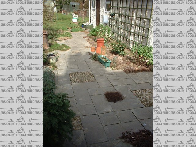

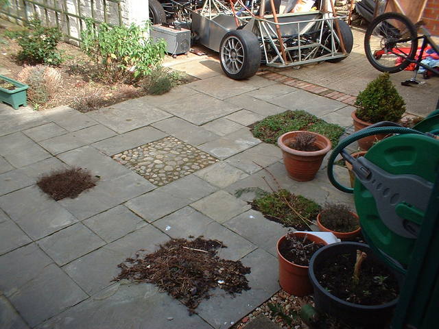

If it helps, me and my mate were tasked with a similar mission for my parents! In fact using the same sized paving slabs as you are. My mum likes
rustic so it had to be random looking complete with holes for plants, little cobbled bits, house bricks and wobbly edges (to be eventually blended in
by green growing stuff).
We bought some slabs then made a scale model on graph paper with bits of paper cut out to represent the slabs we's bought. I placed the full
600x600 slabs first in a uniform distribution so as not to use them all up in half the patio, then basically filled in the gaps with the smaller
slabs. The 600x300s are good for breaking up long lines. You cant do it totally random and avoid all lines with these as they're all the same
size, or multiple of. If you had a 2" stagger say, you'd have to have that the whole length of the patio giving one long line, for example.
That is unless you dont mind holes.
Anyway - here's a couple of photos - hope it helps.
Liam
P.S. I take it you are only after art direction and know how to lay a nice patio - weed-proof membrane, thick layer of sand etc etc etc
