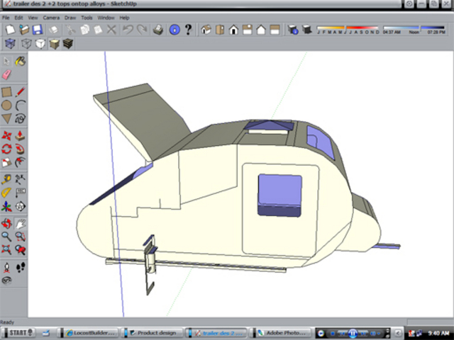

im in the designing process of making a teardrop caravan for the back of the locost, and in need to fit into the 'eco' theme of the course,
im going to fit solar panels to the top of it. as i will be using power at night when there is no light i plan to store it in a motorbike battery (or
if fund allow an aeroplane battery). this is mainly because it needs to be as light as possible, as im going bec. ive been trawling through ebay for
flexible solar panels, but i cannot work out what kind of wattage i need. as i put it needs to charge the battery, run a small air conditioning
unit/heating unit, run a 15" lcd tv, and charge my laptop, maybe whilst im using it. i shouldnt be using both the tv and laptop at the same time,
so that should cut down the power used at one time. i would only need the tv for at most a few hours each night, and probably a similar time for the
laptop (lets hope i dont get a rainy day when i go away).
id like anyone who knows their electricicals (or solar panels) to tell me how i can work out how to work out if it will work !?! i could also do with
some help on what inverters i need to change the power from 12v motorcycle.
so what do you think- would it work and could i do it without spending crazy amounts of money? any input would be greatly appreciated!!
pic if anyones interested: (hopefully will work)

As far as i can tell from the techincal specification on that solar panel, it only provides 2w at 15volts, hence you need 1000 of them to power the
2kw fan heater. A computer is about 400w isnt it? Memory takes a hell of a lot of power to maintain. That too is asking a lot from a battery.
I would strongly recommend using the normal bike generator with a heavy duty car battery, and a small odyssey as a backup, or the other way round. And
dont forget the jump leads! In fact yeah, the other way round. Car has an odyssey, and a removable heavyduty battery in the passanger footwell.
Here here that pissing little thing is the one I use to keep my omega battery topped up.
I have seen 2 off solars on the roof of a commercial vehicle that are about 3 feet by 1 1/2 feet and are used to keep 2 gel batteries fully charged.
The application for the batteries is similar to a tail lift power pack (starter motor turning a hydraulic pump). Said motor probably runs on full load
for 4 mins a day only. I doubt you'd get anywhere near enough panel on the van to be a stand alone power supply.
Buy a small generator (750w output should do you) and use a voltage spike device on the tv and laptop.

I am afraid that solar is not the way to go. Check out yacht chandlers for small wind turbines they are a better bet. While travelling you need to set
up some mechanical charging, if you are not keen to use the engine alternator and a split charge system how about rigging up a drive off the caravan
hub to a car alternator? A good source of compact high power batteries are the carryable boost systems though these are not good for deep
discharge.
Heating is an issue depending on where yo plan to go camping. Insulation is the first starting point 75mm of styrofoam on floors walls and ceilings is
a good start as long as the exterior shell is very waterproof, good windows, not necesarily caravan ones are important. Cheapest heatsource is a gas
cooker and camping gaz bottle stored outside! and as has been said a good sleeping bag is a good thing, though if you are taking a friend get a double
bag

okay, this has all been a great help to get me thinking seriously, ive know realised that with the laptop i can get a tv reciever, and not bother with
a tv at all. the laptop gives out heat which i hadnt thought of, and im now thinking that it would be a good idea to use the excess heat from the hob,
by somehow making a cover for pots that go on it, moving the heat into the main compartment with a small pc fan. this would mean that the wasted heat
from cooking is used, and also i could use it as a simple heater when weather gets cold. so, back to my question, as the laptop is really going to be
the only electrical item (apart from the fan and anything else i think of), how long would i be able to use the laptop for, from a full chatge of a
motorcycle battery,-standard or odyssey? i may still use a small solar panel, just to trickle charge the battery whilst at site. cheers,
