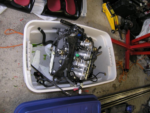

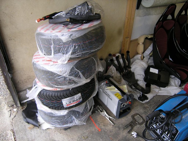

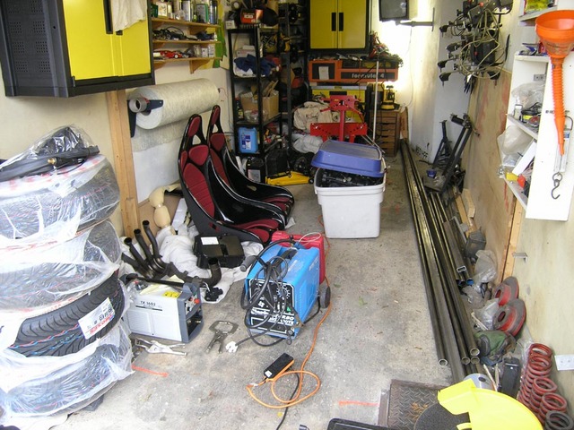

My steel arrived this morning for project X.
I am off to BOC in a minute to get my bottle of Argon for the new TIG.
It will be an "atomesque" MEV rocket type design with all round tube except for the seat mounts, all tig welded.
Watch this space for more progress!!!
Here are some "starting" photos:
  Garage beginning
  Wheels and tig
  seats
  Engine in box

What tube bender do you have then.
Will be interested in your project
nitram38
| posted on 21/5/07 at 08:30 AM |
You can just see the tube bender in the background of the first photo. It is a cheap £80 one from ebay, 16 tons.
It will only be used to produce slight curves. Any tight bends will be bought in, but I don't think that I will be needing any at this stage.

Nice looking Tig set, where abouts did you get it from, and whats the model and make?.. Might be looking for one in the next 6 months..
Dan
nitram38
| posted on 21/5/07 at 10:18 AM |
Dan
Bought on ebay from Italy about a year ago. Not used it yet. Can't remember the cost but I know it was cheaper than similar models in the UK. I
bought one with a footswitch.
Model: Cemont TX 1602

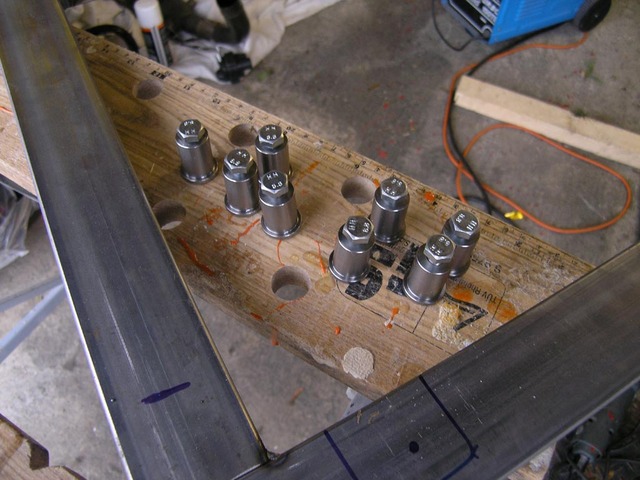

Progress today:
Fitted seat runners to seats and made first part of chassis, the seat subframe.
This will determine the position of the rear firewall, pedals and front subframe which supports the front wishbones.
Seat Subframe:
  seat subframe
Seat bolt mounts to be welded in frame:
  seat mounts
Seats on frame:
  seats on subframe
  seats subframe side
Rough layout in solidworks:
