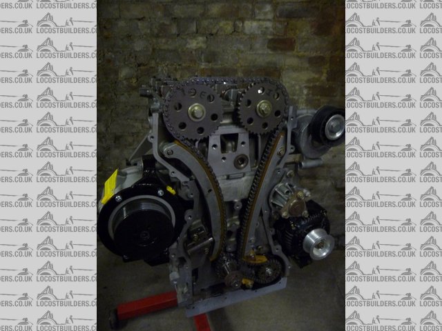

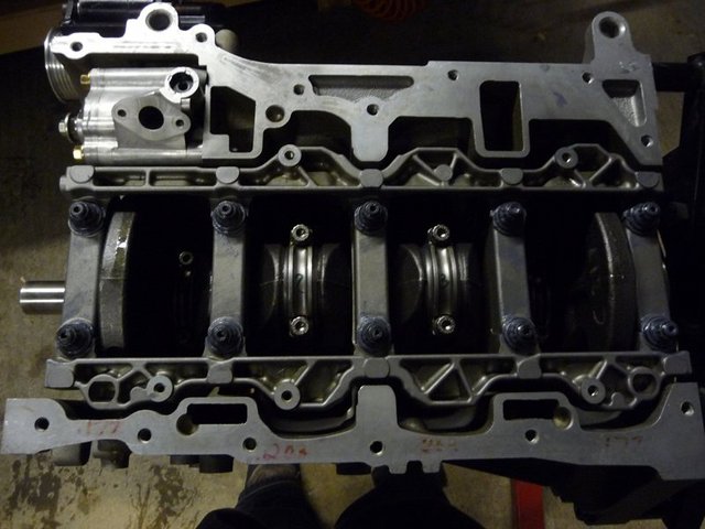

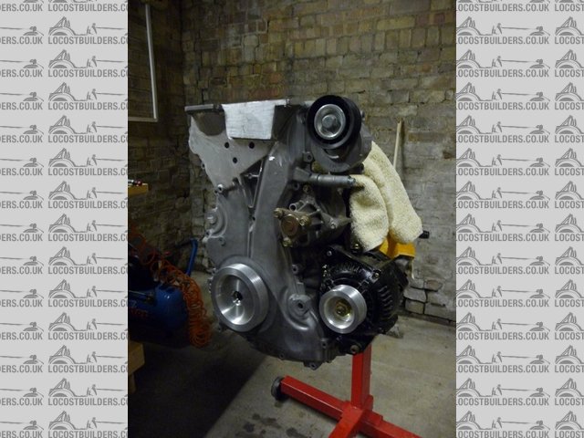

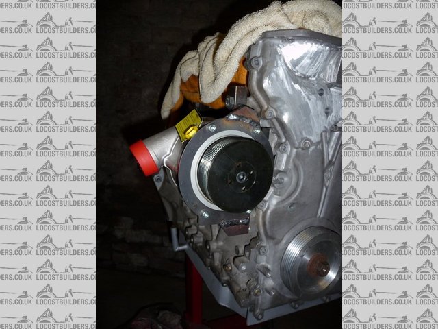

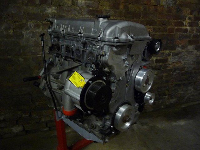

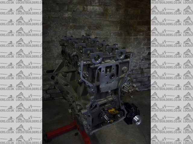

Plodding on with the prep for installing the duratec. Still working on the engine at the moment, but there isnt an awful lot to do now, mainly
assembly. Managed to get it up on the engine stand yesterday which makes working on it much easier!
Engine front
Engine exhuast side

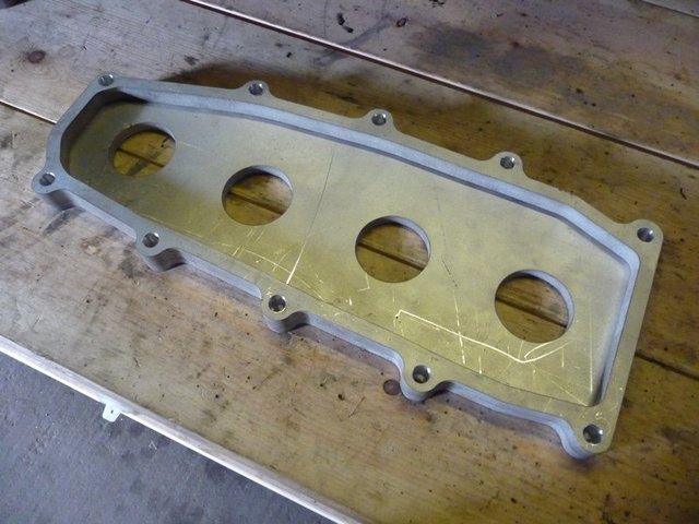

Anyway. Made and fitted the EGR blanking plate in place of the electronic valve. They are available from Ford and Raceline/SB Dev, but I baulked at
paying nearly £40! This one cost me nothing, and 20 mins sweat with a hacksaw and file.
EGR blanking plate

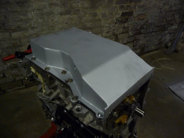

Sump - going to use the one which was fitted to my engine, which seems to be a Transit sump and not a mondeo one. The beauty of this is that its level
with the bottom of the bellhousing within 2 or 3 mm so doesnt need any external mods. Inside its fitted with a windage tray and forward baffle. Just
needs a rear baffle fitting (welding to the windage tray) and it will be just as baffled as the Raceline sump and hold the same amount of oil. I may
add some lateral baffles as well for good measure.
Sump inside before mods

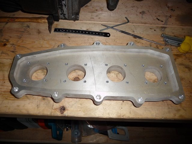

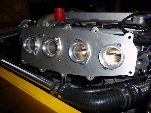

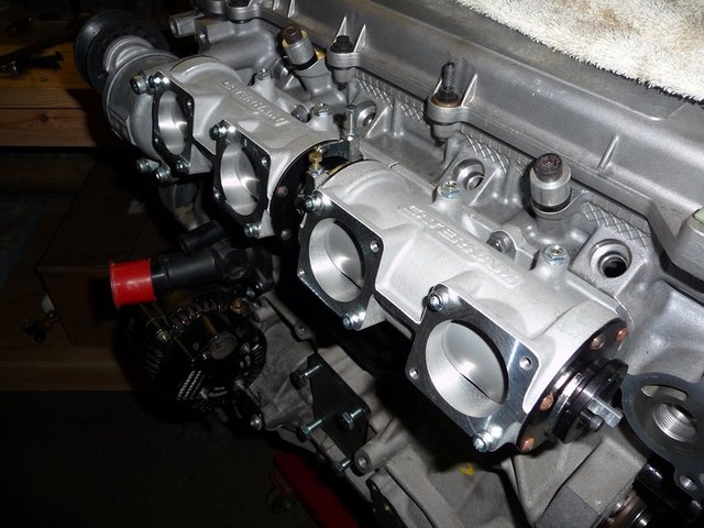

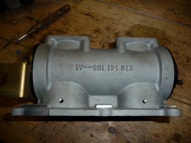

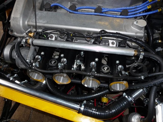

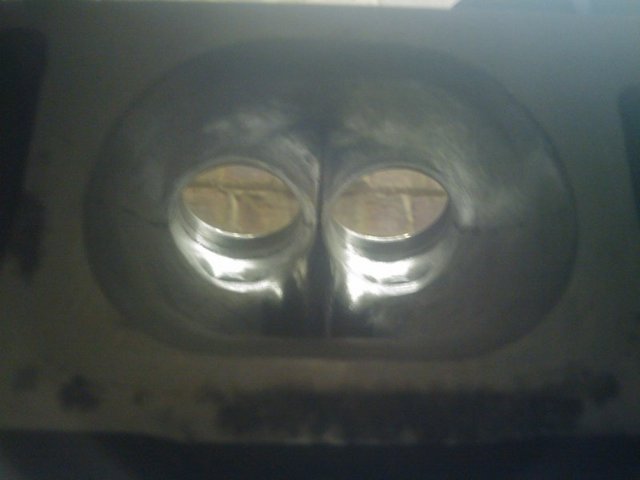

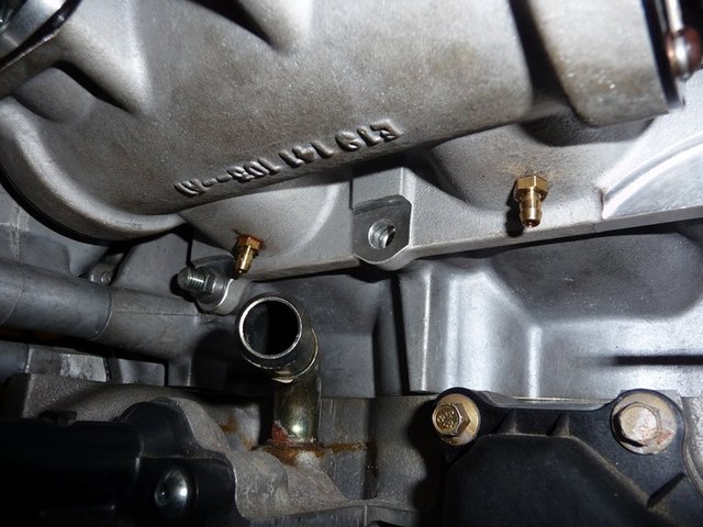

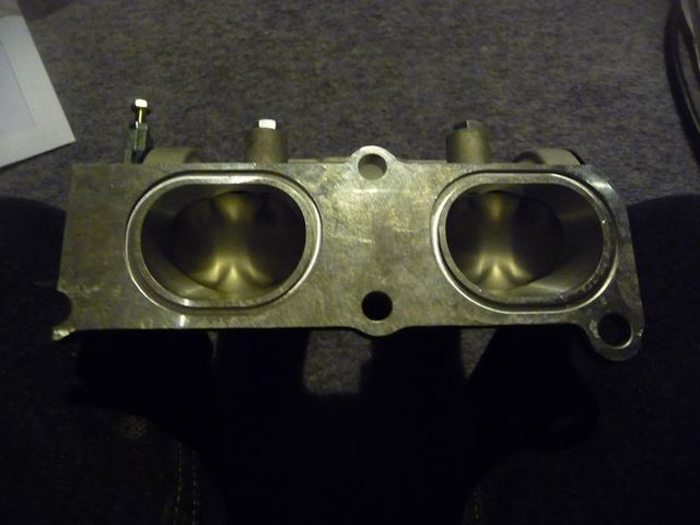

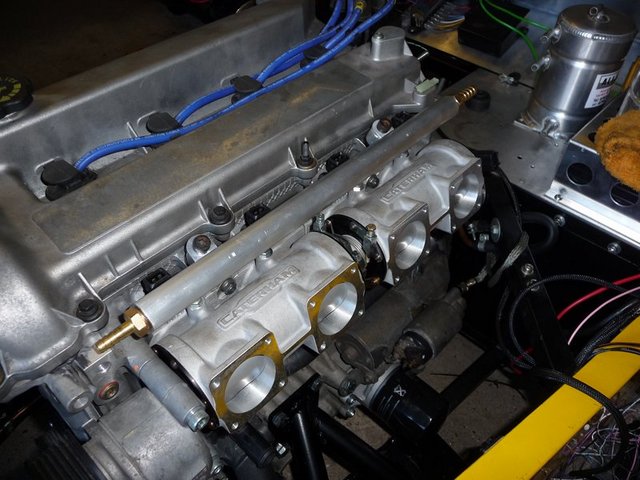

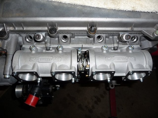

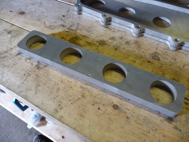

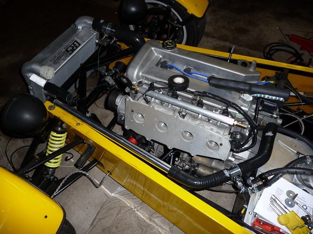

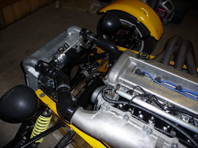

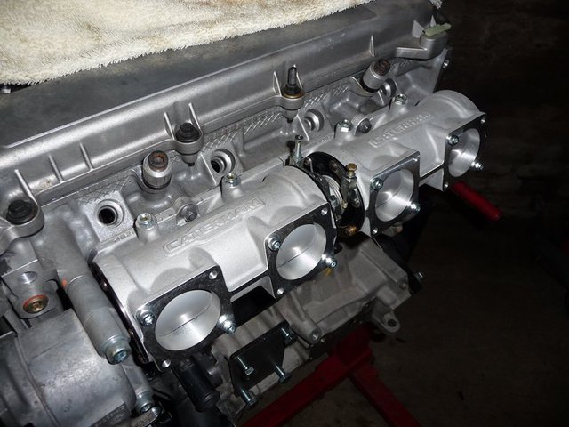

Throttle bodies and injectors. Using GSXR 750 (42mm) throttle bodies which I am going to re-space the suit the inlet port spacing on the engine. Hope
to get my inlet manifold made in the next couple of weeks, which will essentially be a 5mm steel plate with 4 stubby tubes on for attaching the
throttle bodies too. I'll post piccies once I get it done. Again cost is low compared to buying a set of throtle bodies from Webcon or Raceline.
Injectors are mounted direct into the head on the duratec, and as they are bosch ones are an easy upgrade. I have a set of 440cc/min ones on their way
over from the states (less than half the price of over here!) . I will then make a new fuel rail (same as I did on the pinto) to suit them and block
off the injector ports in the throttle bodies.
Again this was a relativley cheap way of sorting induction and fuel and neat too. More piccies to follow as I get it fitted up.
GSXR 750 throttle bodies

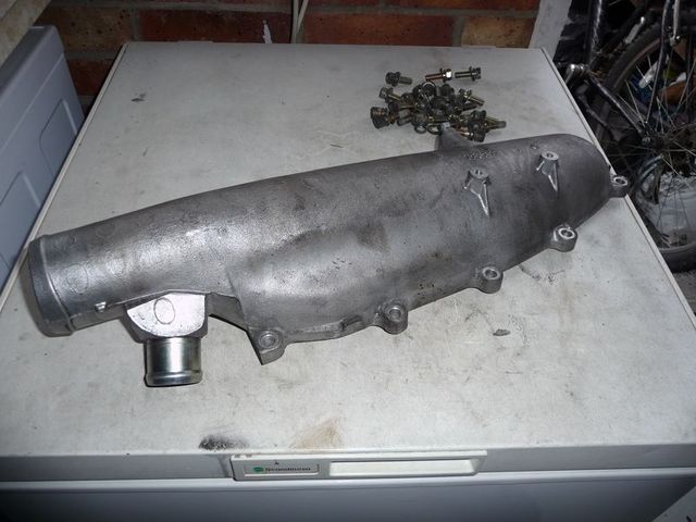

Water pipe to move the inlet on the back of the head to the front to connect to rad.

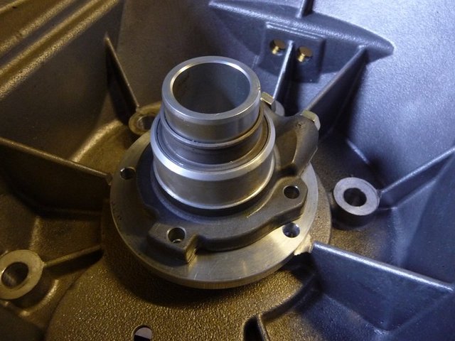

Hydraulic release cylinder spacer for bellhouing.

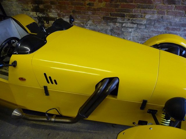

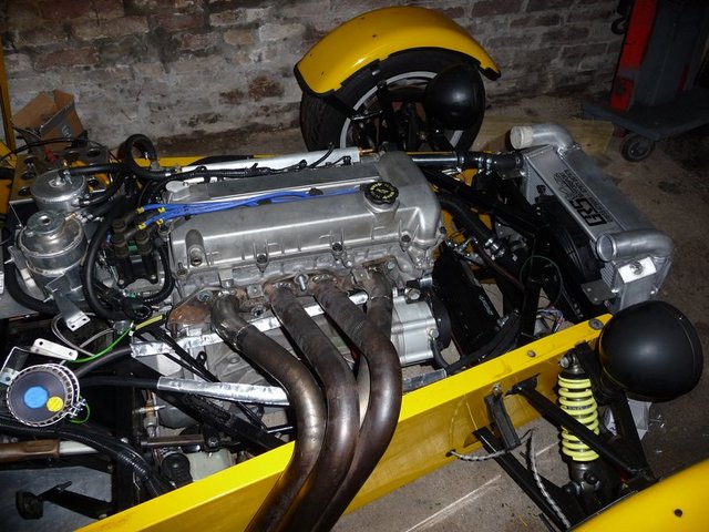

Mod exhuast manifold to keep same bodywork exit point, but suit new por spacing of duratec.

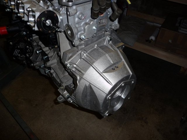

Took delivery of the new bellhousing on friday. Suprised me by how light it was. Secondhand off ebay, but looks like its never been fitted. Paid £120
for it so was worth biding time until once came up! Will allow the engine to go right back in the chassis, the back of the block should end up about
3" from the bulkhead by the looks of it.
For reference there are 2 lengths of bellhousing. 173mm and 192mm to suit the different input shaft lengths of the type 9 boxes. However the
difference in length is on the back of the bellhousing (where it meets up with the box) so the extra material could be milled off if you have one
which is too long, or a 19mm spacer made if you got the short one (if you have access to the equipment of course).
Bellhousing 1
Bellhousing 2

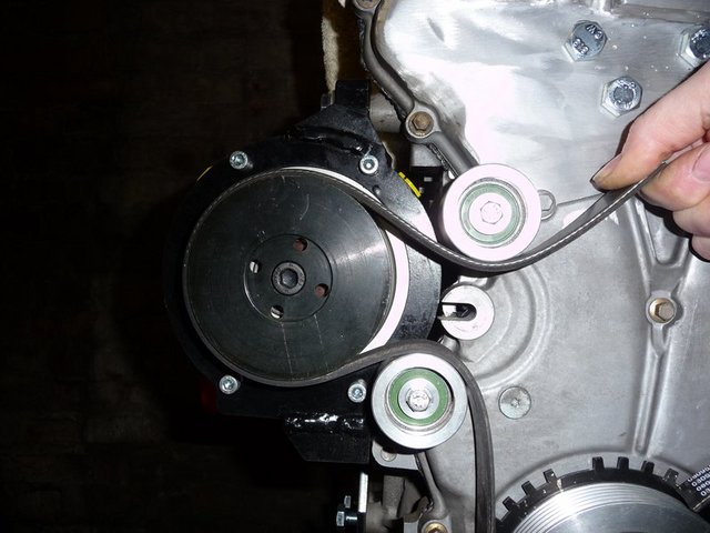

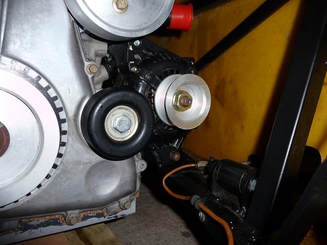

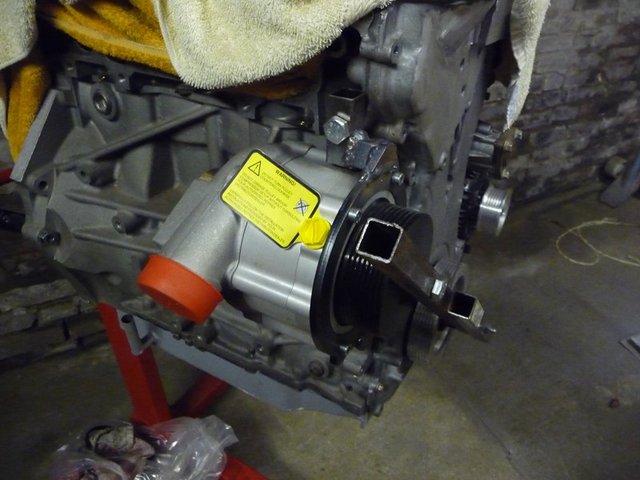

Sourced a very small brand new denso type alternator from a Honda Prelude for all of £20. Rated at 60amps, which is more than enough!
This will be rigidly mounted to the block right at the bottom on the passenger side. Need to figure out how to wire up the 3 wire regulator though.
Another job for the coming weeks is make the brackets to mount it properly.
Alternator

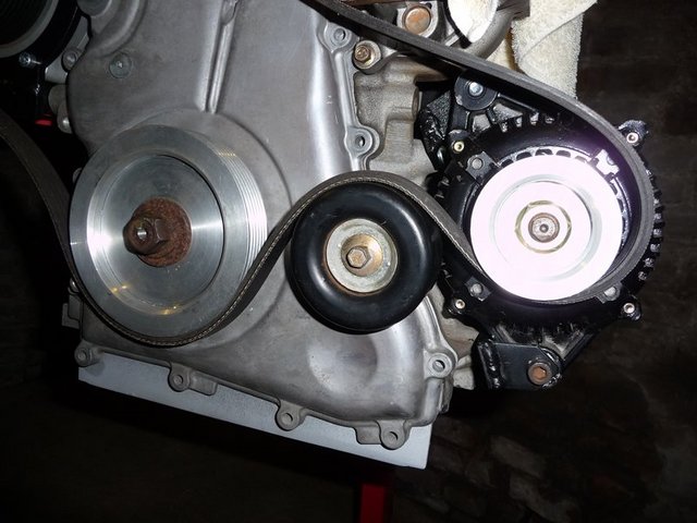

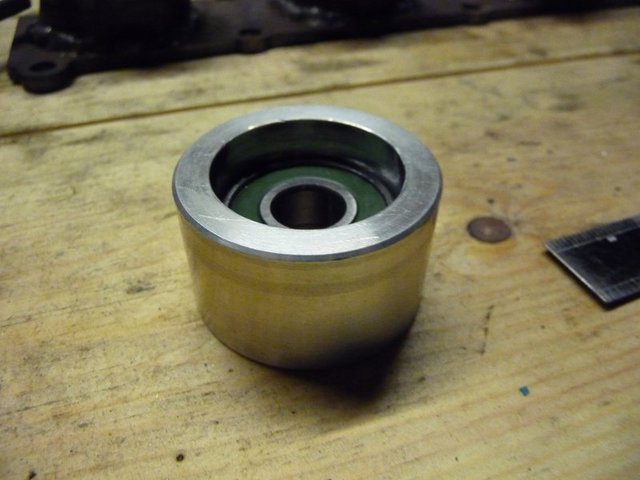

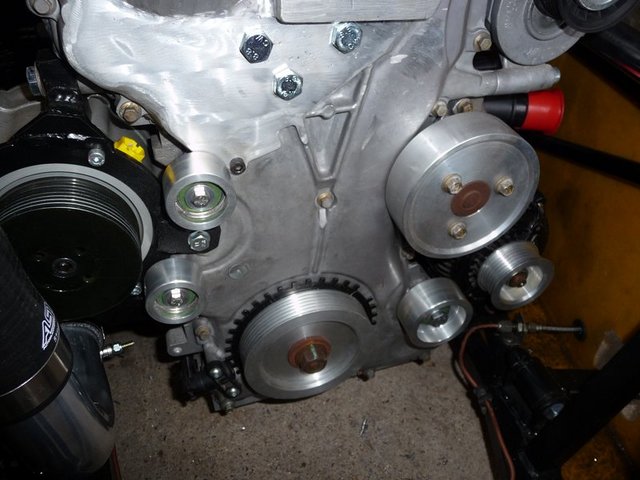

Also sussed out how to tension the aux belt which drives the water pump and alternator. The 2006 onward 1.8 duratec ford focus is fitted with a spring
loaded tensioner. This fits where the power steering pump would normally be on the 2.0 engine. Available from Ford for about £70, but also from the
breakers for about £20. The ford part number is 3M5Q-6A228-AD.
Tensioner
Using the std tensioner is a much simpler and cheaper option than offered by several of the duratec companies...especially if you get one from a
breakers and make the alternator brackets yourself.

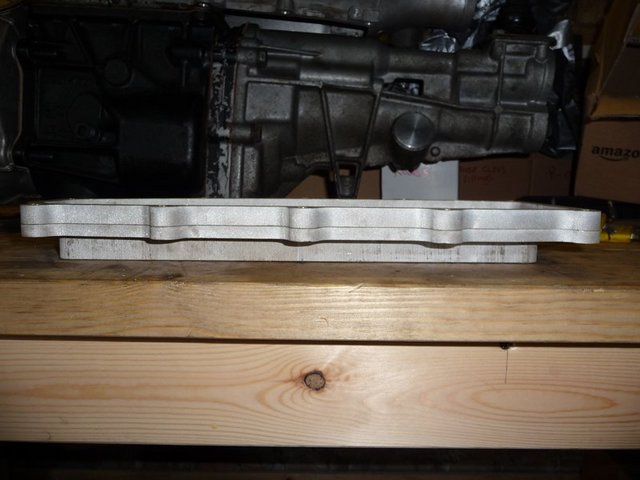

Slight change of plan with the sump. Although the std transit sump is level with the bottom of the std bellhousing, the rwd bellhousings are 27mm
shorter allowing more ground clearance with a shortened sump. So its been a case of back to the drawing board (literally) so....
I have been working on a cad model for a new sump this evening. Loosely based on the one CairB made for his duratec, but with a few tweaks.
I am planning on getting all of the parts laser cut and then getting a friend to TIG weld it all together for me. This will hopefully be available as
a kit of parts in the future as well for others who want to install the duratec engine (also be an inlet manifold plate available) if all goes to
plan. This hasnt been finalised yet I hasten to add!
The large square holes will have a flap fitted to allow oil into the pickup area but not out of it. The baffles all have 1/2" rad cut outs in the
corners and the rearmost one one in the middle too. I may add more holes part way up the baffles? Top plate is 5mm, all others are 1.6mm.
Anyone see any major problems? Or indeed have any suggestions for improvement? I am not sure if the rear most baffle is of any use? Would it be worth
moving the middle one back slightly and doing away with the back one?

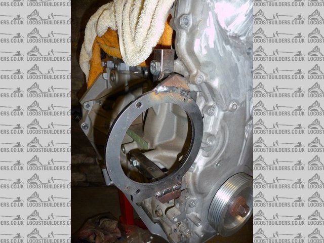

I havent quite finished it yet, as I want to incorporate a plate which also bolts to the bellhousing to make use of the bolt holes and to simply cover
the bottom of the bellhousing neatly. If I can work out a way of making it strong enough then it will be strutural too. I also need to put the holes
in where the front cover bolts on too.

Sump design now complete and will shortly be sent off for laser cutting!
Fingers crossed it all fits together!

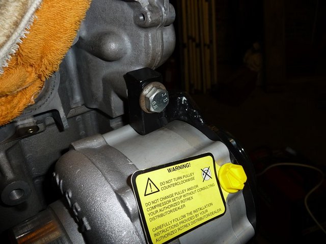

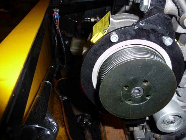

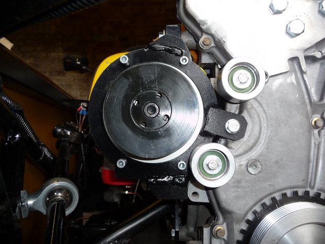

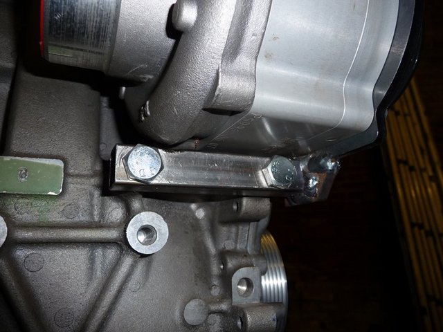

Today I have been working on getting the alternator fitted up (amongst other things!
Mounts fabricated from 5mm steel, they need a bit of trimming up then painting and fitting permanently. I might drill some lightening holes in the
lower mount too.
They position the alternator within about 3mm of the block.
Total cost for alternator and mounts was £20, which I think you will agree is better than over £300....
Alternator mounts
Alternator mounts
Alternator mounts
Alternator fitted

Finished the alternator brackets off today and fitted them up finally
Alternator mounts finished
will measure up for the belt tomorrow.
Unfortunately the laser cutting has been delayed so won't be welding the sump up tomorrow
Will pobably spend the time stripping one of my diffs and driveshafts down instead.
Looks good! How did you go about alligning the pulleys? Straight edge + lots of measuring? frickin' lasers? It's something I'll have to do soon so I'm curious ^_^
The pulleys were aligned using a piece of box section held on the crank pulley by my able assitant while I marked out the alternator brackets and then
tacked them together. Got it right within about 0.25mm which is good enough.
Took a bit of fiddling but got it right in the end.
The measurement from the front of the pulleys to the root of the first vee was the same on both which made the alignment much simpler.
Cool thanks, my crank pulley has a big lip around it so I'll be able to clamp some box section on to it

The parts for the sump arrived on Friday morning, which has meant that inbetween visiting Newark yesterday and all the other usual weekend stuff I
have managed to make a start on getting it welded together.
Check fitted the flanges on friday and all seem to line up well, which was a great relief!
Also spent friday afternoon making all the flap valves and welding them all in (they can be seen in the pics below) and getting them all to operate
smootly.
A slight modification is required to a couple of the baffle lengths and the two sides (a little too generous with the bend allowances, but this will
be rectified in the design now)
Screwed the flange down to a nice thick bit of block board and welded on the end plate which bolts to the front cover of the engine.
The sides were then bent by clamping down to a bench, sandwiched between 2 bits of wood. Allowed for nice clean bends. And I was quite chuffed with
the result considering I was too impatient to wait until tomorrow to bend them on the machine at work tomorrow!
Sump build
Sump build 3
After that the sides were tacked into position, and then the back followed. Nice and easy so far. And having everything laser cut was a joy as it
meant everything fitted together just as expected.
Sump build 2
Sump build 4
The next step was to weld in the baffles. As I mentioned above I had already spent friday fixing in the flap valve parts. The rest is quite easy as I
had slots cut in the baffles so they literally slot together.
Sump build 5
Sump build 6
The next job is to bend the bottom plate to fit and to decide where the dipstick is going to be fitted so I can drill the hole in the side of the sump
for it. I think this will end up toward the back of the sump, and I will be retaining the std mondeo dipstick and tube.
Drain plug fits in the hole in the side which you can see in the pics. Need an M14 nut with one side ground down to suit then a std pinto drain plug
and sealing washer can be used.
All in all its going quite well....I think.....

More progress on the sump construction.
Everything other than the bottom is tacked on now. There is still the windage tray fitting to work out as well.
May have got a bit carried away with shortening the pickup pipe though, what do you think? The pipe angle is the same as the mondeo std i.e the end is
angled to the bottom of the sump. The closest end is within 5mm of the bottom and the other end is 9mm away. Too far or will it be ok?
It will be submerged in a total of 70mm of oil when the oil level is at max.

More sump progress and piccies.
Also decided to get another pick up pipe and have cut it so its parallel with the bottom of the sump, and 5mm clear.
Final job before getting it all TIG'd up is to decide on the position of the dipstick and get the tube welded on. Think its going to go exhaust
side as there is less in the way!
Sump build 11
Sump build 12
Sump build 13
Sump build 14

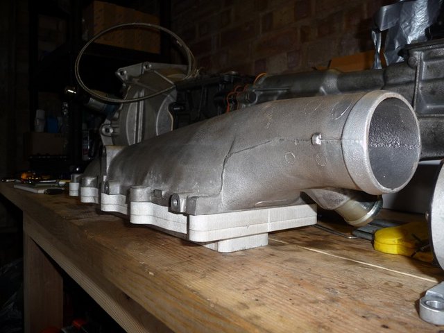

Also finished off the fuel rail, all bar some spacers for the bolts which I'll make this week. And test fitted the laser cut inlet manifold
flange which fits beautifully. I designed it so I could cut away the small lips on the bottom of the inlet ports on the head. What looks like a lip in
the pics is'nt its just where the ali is shiney where I filed it away.
Inlet manifold plate test fit
The tube has arrived for the manifold too. Was a bit tricky to find (48mm OD (1 7/8"
) but got some in the end. Three of the inlet tracts will be
straight (cyls 2-4) and cyl 1 will have a slight angle as the TPS sensor interfered with the belt tensioner otherwise. The trickiest bits going to be
making the angled runner nice and smooth and belend into the odd shaped inlet ports.
Oh well, another challenge which I am sure can be overcome....
that is looking good, so in the sump, are thoses flaps to let oil float freely around, then stop it lossing oil in hard turns?
stuart
The idea of the flaps is to allow oil to flow around freely under normal circumstances and then under hard acceleration/braking/cornering they will
retain the oil in the pick up area.
There are small notches in the baffles too to allow oil to flow around slowly too.
There is also a windage tray to stop oil sloshing up the sides of the block in the corners.
Basically its all about slowing the surge of oil down but it still needs to flow around under normal circumstances.

Sadly due to the position of the aux belt tensioner the runner for the fist throttle body can't be dead straight.
I havent trimmed it up inside yet either as it was still smoking when I took the pics. However its distroted more than I had hoped so need to try and
straighten that out somehow. Any ideas?
I should also point out, although the tops of the tubes are a bit wobbly at the moment its going on the mill at work tomorrow to have them all skimmed
nice and flat

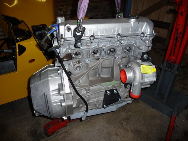

Took the pinto out yesterday and it was collected in the afternoon, so all in a good days work so to speak! No major hiccups other than throwing
gearbox oil everywhere! Forgot about it pouring out of the prop end!

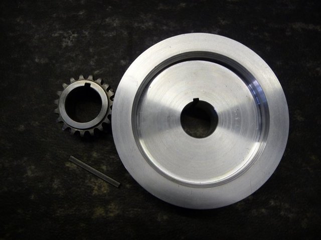

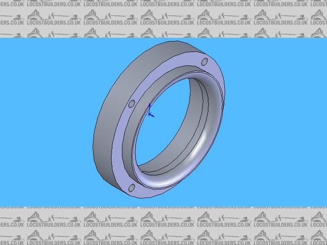

Also finished off my shiney new ali water pump pulley this morning. Slightly underdrive (about 5%) compared to the old one. But also about half the
weight, and I reckon it will look nicer too
Water pump pulley 3
Water pump pulley 2
Also just finished fettling the inlet manifold. Just need to get it skimmed front and back to completely finish it off.
Fitted all the blanking plugs to the throttle bodies so they are now ready to fit.
I am as of yet undecided whether to machine off the old injector fixings. I might leave them as they could come in handy for fixing things too.
What I need to do now is work out how to make a positive retainer to hold the throttle bodies to the manifold. I really dont want them dropping off,
or indeed blowing off when the supercharger is fitted....

This is the water pump pulley fitted
New water pump pulley fitted
Originally posted by Breaker
Any particular reason you want the water pump to run slower (larger pulley) ?
BTW: Duratecs with aircon have a double crankshaft pulley. 1pulley for the water pump and alternator and the other pulley for the aircon. Perhaps you can use the second one for your supercharger ?

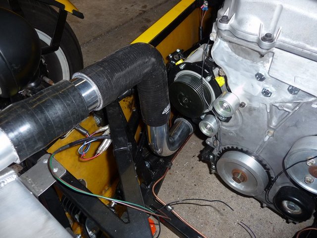

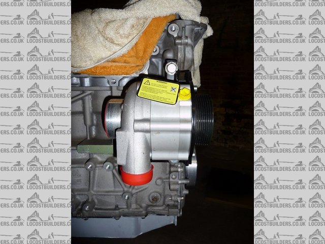

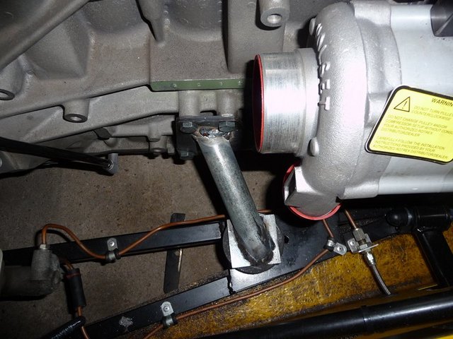

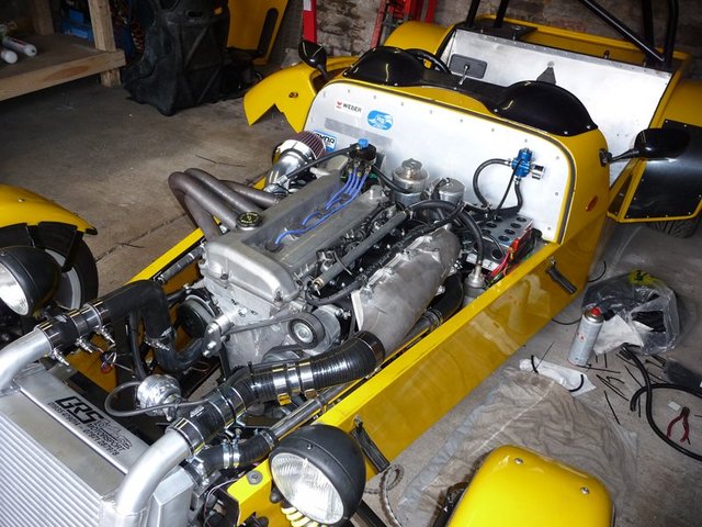

Tried the supercharger up to the block the other day.
Looks like it will fit nicely, still may need to move the steering column though.

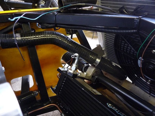

looking very good, can you get to the oil lines ok?? what about running the air hoses from it??

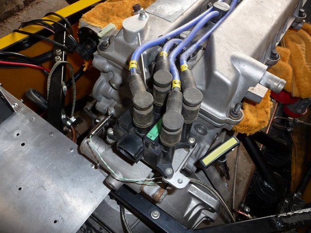

I plan to go the duratec route (swaping from Zetec)and this thread is very informative.
I wonder about one thing.
Where is the trigger pickup located? Does the Duratec use the same principle as the zetec, ie flywheel.
how could i missed that.

The release cylinder/bearing to suit the HD option is one from a Saab 99/900/9000 with a round nose release bearing. It will need an approx 5mm
adaptor/spacer making to fit it to the bellhousing. Which I will be able to supply.
It will also require the central hole in the pressure plate opening out by ~2mm, this can be done with a die grinder/dremel. Or I can machine the

Ali alternator pulley made and fitted yesterday. Needed to make it slightly smaller to keep the speed of the alternator up with the reduced dia crank
pulley.
Ali alternator pulley 1
Ali alternator pulley 2

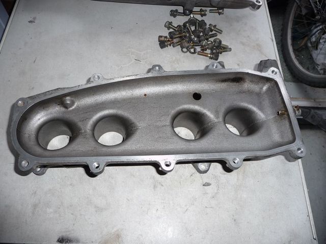

Is there are part number for a normal intake gasket on the Duratec? I've been unable to find a reference and was planning on trying to make one
from gasket material.
Thanks,
Mark
There isnt one as the std intake has 4 moulded o-rings to seal it. The aftermarket cast manifolds use these too.
Like you I will be making one from gasket material.

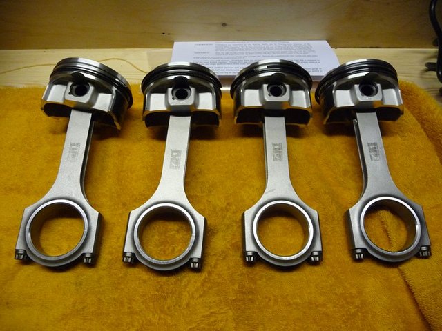

Forged pistons arrived from the staes today. Not bad, 4 working days shipping and not bad on import duty either.
Made in the USA, complete with rings, pins and locks worked out at about £315 for the set.
10:1 compression ratio, so slightly lower than the standard 10.8:1 but near enough for me.

Going to get both my ali crank pulley and the std one keyed I think.

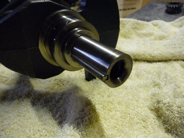

Took the crank down to Scholar Engines in near Stowmarket to get the crank keyed. Top job and turned it around in 2 hours for me as well! So I was
home just after lunch.
Keyed crank
keyed pulley and gear

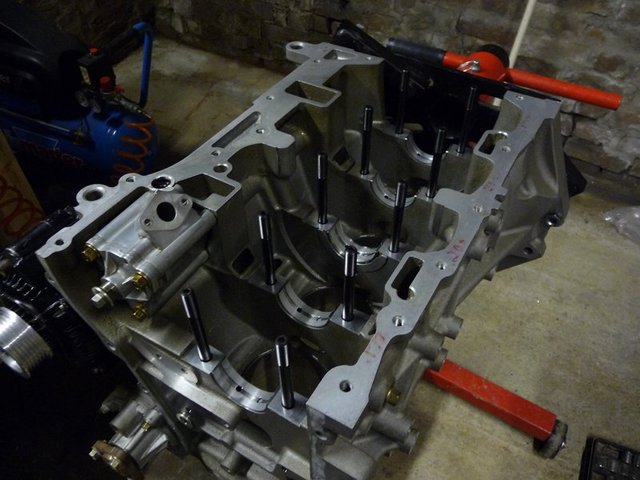

Cleaned it all up and fitted to the block. Torqued up the ARP main studs then fitted the conrods to the crank, again with ARP bolts.
Crank and rods refitted
Then fitted the gear to the crank and the oil pump and fitted the modified oil pick up pipe.

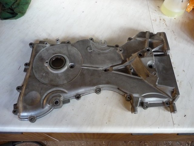

I also nearly finished modifying the chain cover. The engine mount is redundant and possibly in the way of the belt so I cut it off with the grinder.
Still need to tidy it up a bit, then probably paint the cover to tidy it up, though I may not.
This is the std front cover with the fwd engine mount
Std front cover
And this is the same cover with the mount removed
Modded front cover
I will make some bungs for the old bolt holes too as they arent required any more either. Or I could counterbore the holes and fit cap heads. Not

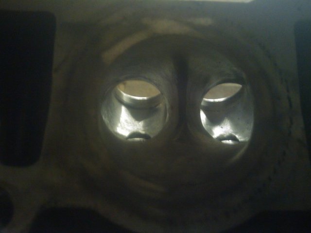

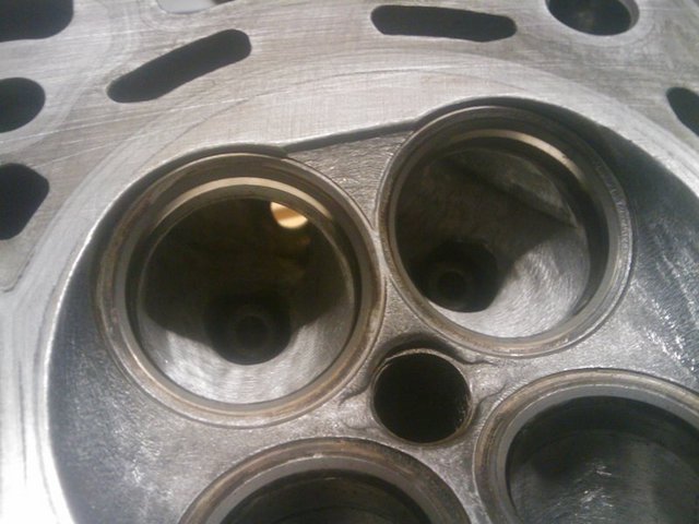

Been fettling the head and getting it ready to fit this weekend, in amongst pulling some ceilings down in the flat. So all in all a productive and

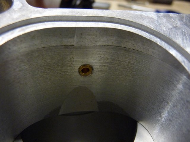

destructive weekend all around!
I took the oppotunity while the head was off to remove all the casting marks from the ports and smooth off the short turns in the inlet ports as these
had a sharp edge in, similar to that seen in the early pinto heads. Other than that the ports are incredibly well shaped from the factory so I didnt
remove a lot of material.
My felxi shaft broke halfway through which means I couldnt really touch the dividers in the ports as I didnt have enough reach, that said they arent
bad, and with the amount of turbulence the supercharger is going to create I dont think it will matter too much!
I also removed all the sharp edges from the inside of the combustion chamber to prevent any hotspots then gave them a quick once over to smooth them
over. There isnt really a spotface for the valve inserts, which was good, so other than removing the edge, they were left as machined.
Final job was to lap the valves in which didnt take too long as the seats were in very good condition anyway.
Heres the pics of the finished article. Apologies for the crappy quality, forgot my camera today so these are off the phone!
Inlet ports:
Head rebuild 1
Head rebuild 3
Head rebuild 6
General view of combustion chambers:
Head rebuild 2
Exhaust ports:
Head rebuild 4
Head rebuild 5
All this was followed by a thorough hosing down and blowing all the passages out with the airline to remove all traces of swarf.
Just waiting for the uprated valve springs to arrive now. Thought it was worth fitting them now while the head was off, so if I decide to change the
cam at any time I dont need to take the head off again!

This morning I made my clutch slave cylinder spacer. I skimmed a bit of material off the bellhousing so I could make a spacer thick enough to
counterbore the heads of the SHCS into it.
Not bolted it in yet.
Clutch spacer

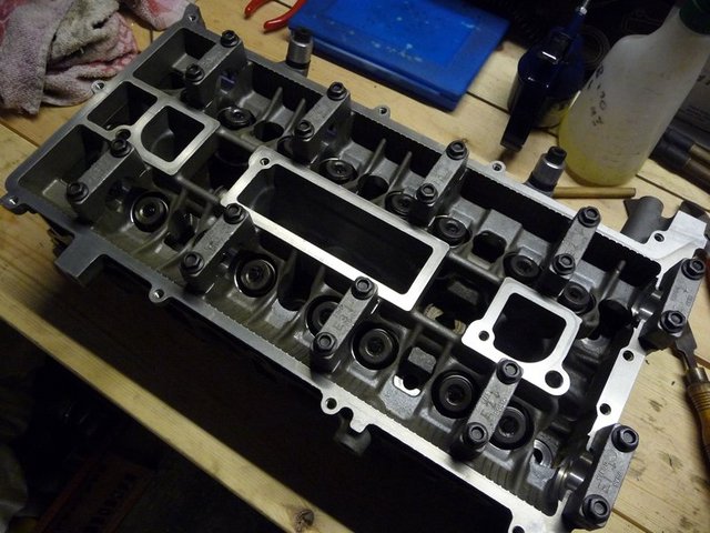

Refitted all the valves to the cylinder head yesterday afternoon. Bit of a tedious job. Found the best way to refit the collets was with some grease
on a screwdriver, unless you have really small fingers!
Springs were replaced with uprated kent cams ones as the standard ones are a bit weak.
Head rebuild 7
Head rebuild 9
Head rebuild 10

Then I fitted the new sump. Leak tested it last night and all seemed ok, then fitted the windage tray and then cleaned it all out again. Sprayed it
with high temp paint this morning before starting the other jobs. Its more silver than it looks in the pics.
Put a bead of loctite 5900 around the flange and popped it on the engine. A bit of a fiddle to ensure the flaps dont get stuck in the wrong place.
Sump fitted 1
Sump fitted 2

Quick question - how the hell does the alternator tensioner work on these engines?
We have the one from the 2.0 mondeo (but will be using the 1800 foci one as you have) but it looks like they both operate in a similar manner.
Are they sprung? We cant get ours to move in any direction at all?! It has a couple of arrows on but we've had it in a vice etc trying to move it
but no luck?
Is there any adjustment in them?
Hi Dan,
The focus one swivels.
Looking at it from the front (pulley side) it should be spring loaded if you try and turn it anticlockwise. Put a big spanner on the hex in the middle
of the pulley and try to turn it anticlockwise and it should move against the spring.
The mondeo one is also similar but fits on the bottom left of the block.

Thats correct. Turn tensioner anticlockwise with spanner, then slip the belt over and release.

Got the supercharger mount 90% finished today. Need to tidy up some of the welds and cap the ends of the box section.
The box is 20x20x1.5, the laser cut plate is 6mm steel. The box has crush tubes welded in where the bolts go through.
The alignment is pretty good I think. Within about .25mm. Having had a measure up for a shim, it only needs a 0.7mm shim behind the front bolt at the
bottom to make it spot on.
Having done some calcs the supercharger is going to pull around 15bhp at 7250rpm and 14psi boost. Hopefully the brackets will take it.
Charger mounting 4
Charger mounting 5
Charger mounting 6
Charger mounting 8
Charger mounting 9
[Edited on 28/12/09 by flak monkey]
looks very good dave, looks nice and tight to the block too which is vital
Thanks, yep theres not much space. The laser cut plate is touching the front cover, I need to trim a little off it. Theres just enough space to get
the oil feed banjo on next to the block
Had a measure up today and defo need to move the steering column. Will wait to get the engine in and see where its going to fit!
lol, i was thinking the same. may have to move a few bits and bobs
15 HP at 7000RPM (i'm assuming crank and compressor pulley are approximately the same diameter) equates to 15Nm of torque or, when using a pulley
diameter of 3 inch, roughly 200N of force on the outer edge of the pulley. Looking at the brackets you've made, the compressor might try to
rotate around its height axis. Could you add a gusset between the box section of the bottom mount and the lasercut compressor mount plate to prevent
this? It looks like it would need to be below the box section and that you'd need to switch to allen bolts.
Does this make sense?
[Edited on 28/12/09 by sebastiaan]
Thanks for that.
I did wonder about fitting a gusset at the bottom. Would need to weld another piece of plate on along the bottom of the laser cut
plate though.
I understand where the torque fig comes from, but not sure about the force one?
If the pulley needs 15Nm of torque to turn it at 7000rpm then the force is the radius of the pulley divided by the torque isnt it? So for a 3"
pulley that would equate to 400N.
The pulley on the supercharger is 95mm OD so the force would be 315N or ~32kg. I may end up with a smaller pulley though, depending on how much boost
is lost in the rest of the system and how mental I feel once I have driven it for the first time!
ETA: Just found this
http://www.tribology-abc.com/calculators/e3_5a.htm
Plugging the relevant numbers in gives a shaft load of 302N so the calcs above arent far out.
[Edited on 29/12/09 by flak monkey]
Finished the supercharger mount yesterday morning, and just made myself a shim to align the pulleys perfectly.
Incidently I found that Gates specify a maximum shaft parallelism error of 0.25 degrees for poly vee drives.
Finished charger mount 1
Finished charger mount 2
Finished charger mount 3
I have also been having a looking at where to put idlers for the best belt wrap on the crank pulley and the supercharger pulley.
I think one of the standard Duratec idlers will work between the crank and the alternator. Need to just swap the bolt out for a 10mm one.
Idlers 2
I then need to make 2 more, a 45mm and 50mm one for either side of the supercharger pulley

Took delivery of a set of Nissan Sunny GTiR throttle bodies with their plenum today.
Plenum 1
Plenum 2
Its nicely shaped and has a handy port for the dump valve to be fitted to as well. Its also exceptionally lightweight - which suprised me somewhat.
The idea is to use the plenum, with a modified backplate connect to my GSXR throttle bodies.
I will probably cut the back out of the existing backplate (below) and then have a 5mm thick aluminium plate welded in with stub tubes to suit the
GSXR throttle bodies. Then I just need to figure out how to bolt it all together so it doesnt blow itself apart.
Plenum 3
The port spacing of the throttle bodies does match the Duratec, but sadly I cannot see a way to mount them up to the head particularly easily. Not and
keep the flow into the head nice and smooth anyway.
And this is what I intend to make to mate the plenum to the throttle bodies.
The plate is 6mm laser cut aluminium. The adaptors to fit on the throttle bodies fit into this, held on with 4 off M4 dome head screws, loctited
in.
GTiR plenum adaptor cad
The adaptors themselves will be turned fom aluminium and glued to the throttle bodies with Loctite 648 retaining adhesive.
Hopefully it should make for a neat and compact solution to feeding the throttle bodies with the inlet charge from the intercooler

I also made 2 45mm dia idler pulleys to fit either side of the supercharger pulley to increase the wrap and to keep the belt out of the way of other
important things!
This highlighted the fact that I need to shave another 1mm off the front cover. The measurements suggest that this will leave it 2mm thick. If I dont
go too mad with the angry grinder!
Idler pulley
One goes here:
Idler pulley 2
And the other goes in the other bolt hole just below the belt in the pic. Gives loads of wrap on the pulley and hopefully will stop it slipping.

Finished the assembly of the engine today
Setting up the cam timing:
Cams fitted 2
Left the cam sprockets loose to allow the crank to be rotated to TDC before tightening the bolts up to lock off the cams.
Cams fitted 3
Finding TDC
I then fitted the front cover, sealed with Loctite 5900. Managed to shear one of the bolts off though, so will be drilling that out tomorrow!
Then fitted the new cam cover gaskets and fitted the cover. The water pump pulley. Just need to get some longer M6 bolts for the idler pulleys so I
can get them fitted and get measured up for the belt, which will no doubt be fun.
Finshed engine 1
Finished engine 2

Finished fitting the idler pulleys tonight, also got a rough idea of the length of belt needed. Looks to be around 2 to 2.1m
Pulleys finished 1
Pulleys finished 2
Pulleys finished

I made them
I couldnt find any the right size.
I put highspeed bearings in anyway.
They are bolted into two of the front cover holes.
Another shiney present arrived today. A set of Caterham branded Cosworth roller barrels!
They bolt direct to the cylinderhead, which means I might just be able to keep the plenum inside the confines of the bonnet for the sleeper look. They
are only 95mm deep without the trumpets fitted.
The intension is to make a backplate for the plenum to bolt direct to the throttlebodies now, rather than all the bits and pieces I was going to do
with the GSXR ones!
I just need to find some much shorter trumpets to fit so I can fit some inside the plenum.

And the final thing is I need to find a TPS to fit on here:
Roller barrels 3
I know what I will be doing tomorrow evening
looks like ford zetec E tps woudl fit that, i do happen to have one lying about too
ps, may get in touch about some idler's too if cool, still got issue with dry sump though, would have to make all the bits to move it
across....not good. lol.
Just fitted the new roller barrels. Snug fit next to the tensioner, and looks like I will need an additional spacer to allow the plenum to clear the
tensioner. I guess the other alternative is to change the tensioner.
Roller barrels fitted 1
Roller barrels fitted 2
Roller barrels fitted 4
Roller barrels fitted 3
caterham parts show one for non roller barrell so assume the other is for roller bearings. or could go for raceline
The tensioner fits ok, its the fact I need a spacer to make the plenum clear it now

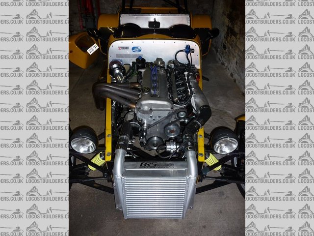

Also expecting my radiator/intercooler in the next couple of weeks

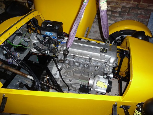

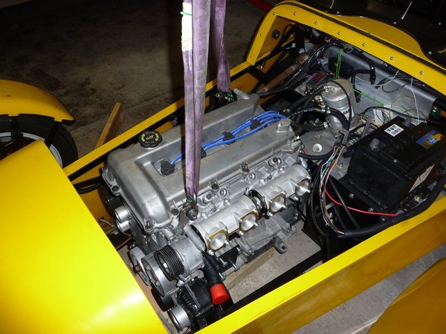

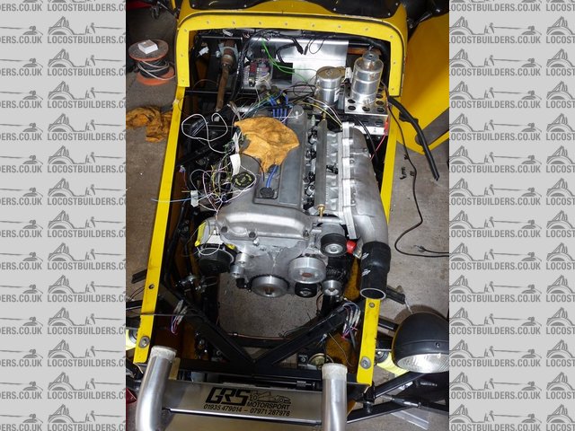

Big day today. Decided to get the engine trial fitted in the chassis, thankfully everything seems to fit and I am very pleased that I put the
supercharger on the exhaust side, I dont think it would have fitted in the chassis on the inlet side.
Fitted the bellhousing to the engine as this will determine the fore/aft position of the engine in the chassis ultimately.
Engine test fitting 1
Engine test fitting 2
Then dropped the engine into the bay (obviously with the nose off to start with!)
Engine test fitting 3
Engine test fitting 4
Then spent a little time getting the height right. There is about 5mm clearance to the bonnet, which should hopefully be enough. I could alway make a
new lower profile cap at a later date.
Engine test fitting 5
The sump will be around 25mm below the chassis, which is less than the pinto was, so I will end up with a little more ground clearance
Engine test fitting 10

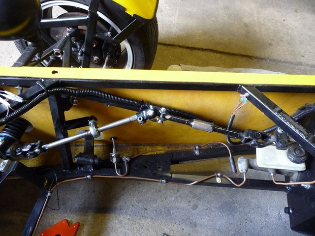

Thankfully only one more joint is needed in the steering column and the rally design plined column is exactly the right length for the second link. So
now I need to make some supports for some rose joints to hold this part.
Engine test fitting 6
Theres around 25mm clearance all around the bellhousing cut aways. Which is nice. The engine can't really go any further back anway. In this
position the gearstick should also be in about the right place I think.
Engine test fitting 7
Theres about 10mm between the alternator bracket and the brake pipe. I need to make a new pipe anyway, so will try and make some more room around
here
Engine test fitting 8

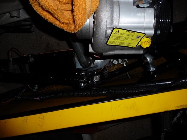

But plenty of room around the rotrex for the column
Engine test fitting 9
Tomorrows job is to make the engine mounts and steering column support mounts too
Engine test fitting 11
[Edited on 22/1/10 by flak monkey]

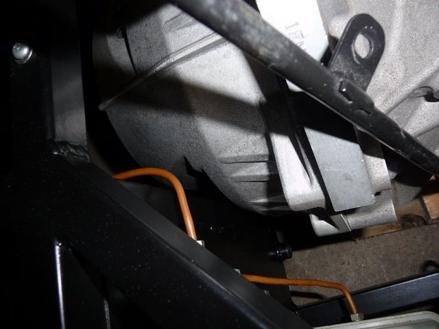

Thanks Sebastiaan, I did fit the gearbox this morning as I was thinking the same thing
The gearbox is snug, but theres at least 10mm clearance all around. It physically cannot go any further back though.
I need to tidy up where I roughly ground off the old gearbox mounts this morning. I will be making new ones tomorrow from box section.

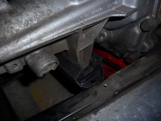

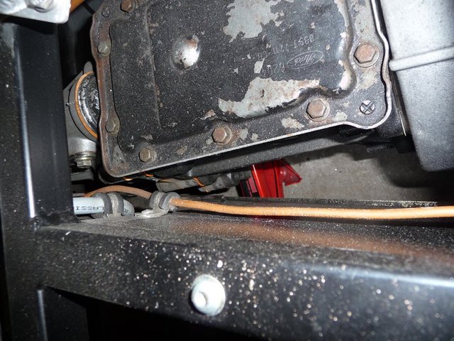

Gearbox fitted 1
I will be modifying the westy/caterham gearbox mount slighty to allow me to fit a piece of 20x20 box each side to bolt it to.
Gearbox fitted 2
There's not an awful lot of room down there. The brake pipe is actually well away from the box, not how it looks in the pic, must be the angle
Gearbox fitted 3

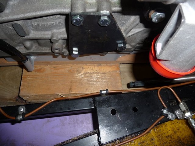

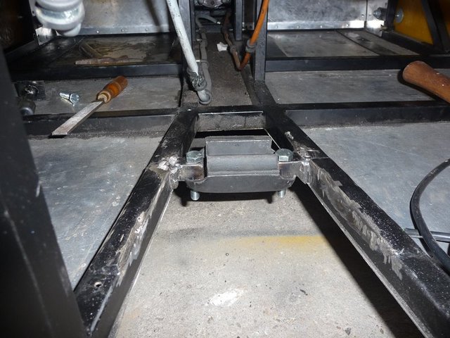

Got the gearbox mounts welded in today. After a bit of hassle with the welder, think I could do with a new liner. No problem with the weld pentration,
just not very tidy!
Anyway, made 2 closed end tubes with crush tubes in to bolt the westy gearbox mount to.
Gearbox mount
Will get a coat of paint on it one evening this week.
Had to split the engine and box again to fit the flywheel and clutch. St150 flywheel fitted with ARP bolts. Cover is an AP racing CP3560-2 rated to
230lbft of torque (expecting around 220lbft) and a competition AP racing pinto friction plate (CP5351-1).
Flywheel and clutch fitted
Also spent a bit of time cleaning the car inside, as everything was covered in oil from when the pinto was extracted, and then covered in angry
grinder dust, so now a much nicer place to work

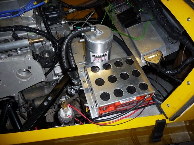

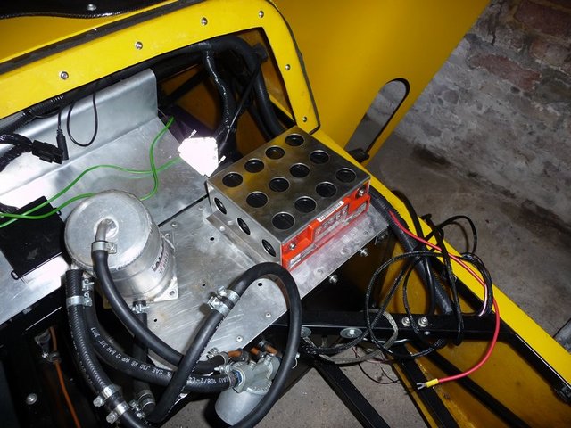

Removed the old battery and now there's space for the shiney new one!
New battery
Seems like a few steps backward today as well as the engine and box are out again and wont be back in until I have a new prop shaft.
Next job is to determine how much clutch pedal travel I need to get the release bearing travel I need. Which means getting some adaptors made for the
hydraulics. Then I can get the master cylinder fitted and new clutch pedal made next weekend. Also need to start thinking about finally fitting the

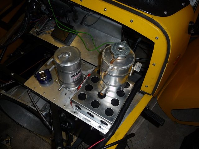

battery, swirlpot, rotrex oil tank and header tank on the footwell tops. Should be enough space anyway. I would also like to get the steering column
refitted with the extra link.

Looking real nice. Really can't wait to see it running and driving

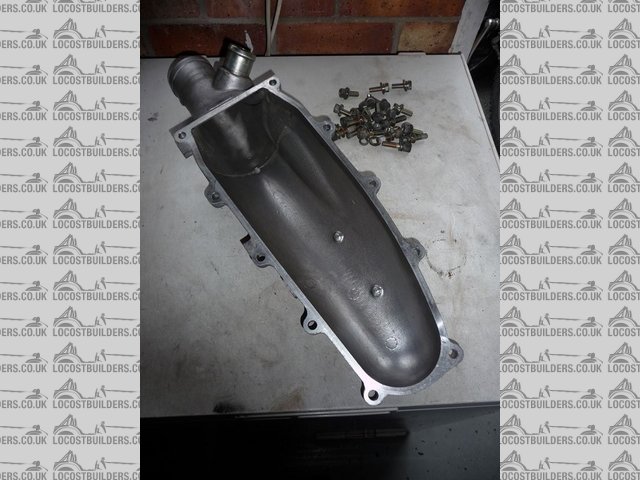

The job for today was drilling and tapping all of the plenum parts. I had the plates water jet cut by andyw7de who did an excellent job, and very
quick too (5 days turn around).
There are 3 plates, 1 spacer plate to give a little more room inside the plenum, this is 1/2" thick. 1 back plate for the plenum which is 8mm
thick and then a spacer plate to space the plenum out enough to clear the tensioner, this is 3/4" thick.
Backplate and spacer after drilling and tappping
Plenum bits 1
3/4" spacer before drilling to suit throttle bodies
Plenum bits 2
And the final thing after lots of marking out and drilling! Hopedully it will all fit nicely.
Plenum bits 3
Plenum bits 4
Plenum bits 5

Not sure what you mean about pics inside the plenum? The inside looks exactly as shown above....
I will be fitting the shortest trumpets I can inside the plenum, IIRC they are 15mm long. I also need to drill and tap the backplate for the air temp
sensor to fit into. Need to work out the temp curve for the cosworth air temp sensor......

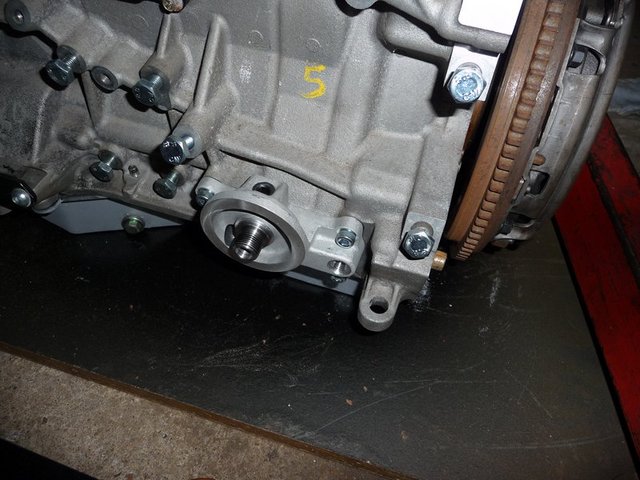

Fitted the oil filter housing from Raceline, was expecting it until next week, but there we go
Fingers crossed the filter will clear the
chassis.
Oil filter housing
Bolted down the battery on the top of the footwell. Amazingly small compared to the old one, and will allow me to mount the header tank above it and
still clear the bonnet. This will leave me more room to fit the swirl pot and oil tank for the rotrex up on the footwells too.
Battery and tanks

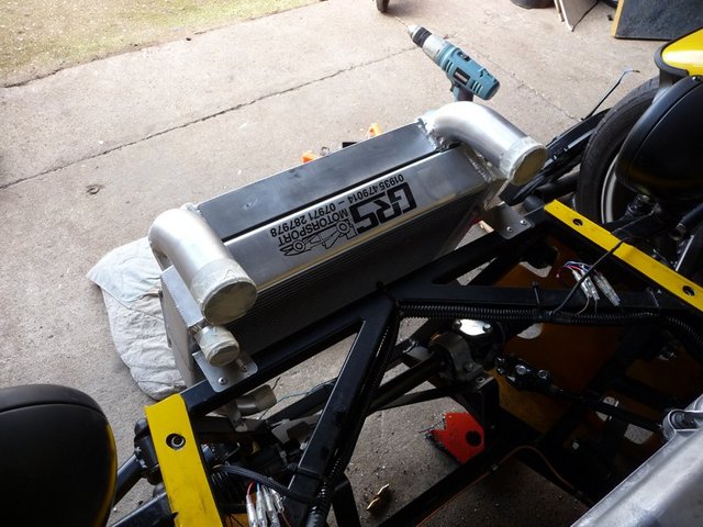

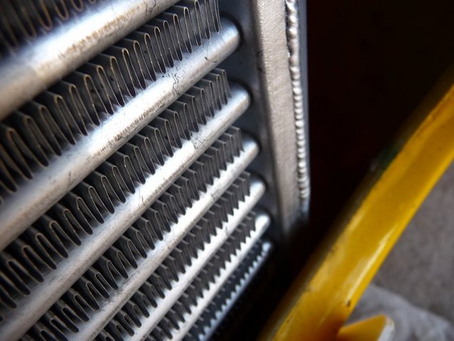

GRS have just sent some more piccies of the radiator and intercooler over for my perusal
Looks like its coming on well. Theres just the tight 90deg
50mm tubes to weld on by the looks of it. The intercooler is 50mm core, and bolts to the front of the radiator. I will fit some strips top and bottom
to force any air that goes through the intercooler to pass through the radiator too...unless GRS beat me to it
And no its not cheap
But should be more than adequate!
Made a little more progress yesterday, and dropped the engine and gearbox in finally tonight. Need to torque the bellhouing bolts, but access is
easy.
Welded in some additional plates on the chassis, the intention being that tomorrow I will be spending the day beefing up the engine mounts by adding
in another tube and rubber mount on each one.
Mount plates 1
Mount plates 2
Drilled the hole in the bulkhead for the clutch master cylinder. Should give a pedal ratio of around 4.5:1 which should give a light enough pedal and
progressive clutch hopefully! Though yet to try it out...
Also made a new brake pipe to avoid the master cylinder and tidy it all up a bit as I never was happy with the original pipe work.
Clutch cylinder mount and new

Fitted the oil filter as well so I know how much room I have for the engine mount modifications. Thankfully there's plenty of room around
there.
Oil filter fitted

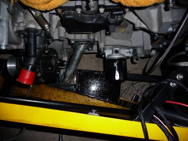

Finished off the engine mounts today after concerns they werent up to the job. Hopefully now they should take the stick!
This pic shows the angle of the mounts from the front
Finished engine mounts 1
Passenger side
Finished engine mounts 4
Drivers side
Finished engine mounts 3

Modded the throttle bodies tonight to give me a point to take a MAP signal from each. Oddly most off the shelf throttle bodies seem to only come with
TPS as standard and no option for map.
Nerve racking drilling into several hundred quids worth of throttle bodies, but there we go...
Fitted an M5 threaded, 4mm hose tail into each port. Sealed in with Loctite 542 thread sealant.
Once modded they were fitted up again, and hopefully wont be coming off again any time soon
Throttle stops all set and locked off too to cosworths
recommended base settings.
Throttle body mods 1
Throttle body mods 2
Throttle body mods 3
Throttle body mods 14
Throttle body mods 5

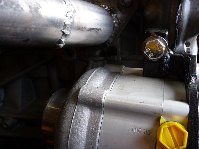

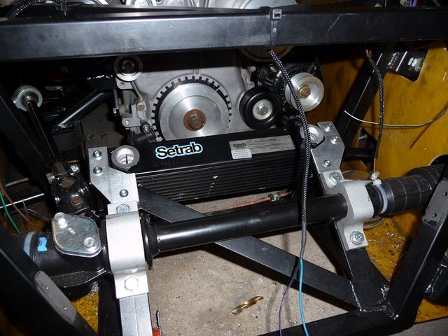

First job was to add another bit to the supercharger bracket. There was a bolt hole in just the right place, and the mod should stiffen up the bracket
as I was concerned about it twisting should I start to increase boost.
Supercharger mount mod 2
Also got the water outlet fitted after drilling and tapping to fit the water temp thermocouple for the dash. Can start working out the cooling pipe
layout, along with fuel pipe layout etc.
Water outlet and coil

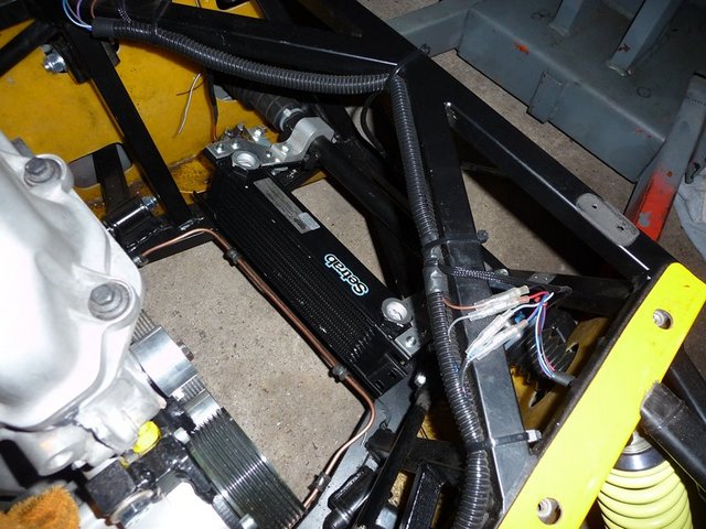

Next started making the mounting brackets for the supercharger oil cooler.
Charger oil cooler 1
Charger oil cooler 2
Tomorrow I plan to start having a look at the mounts for the rad/intercooler. Then I really need to test out the hydraulic clutch before finally

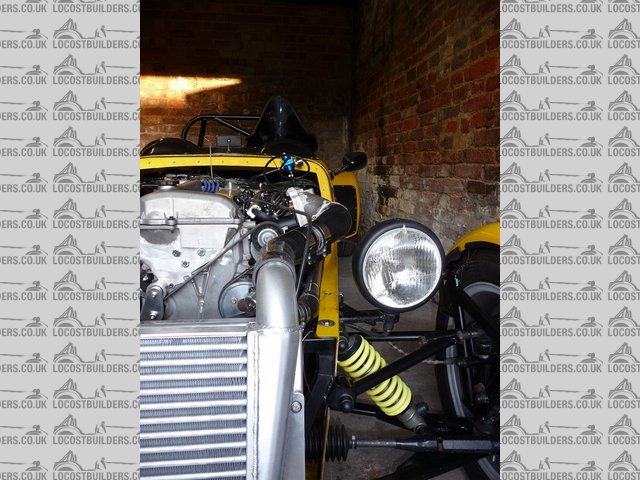

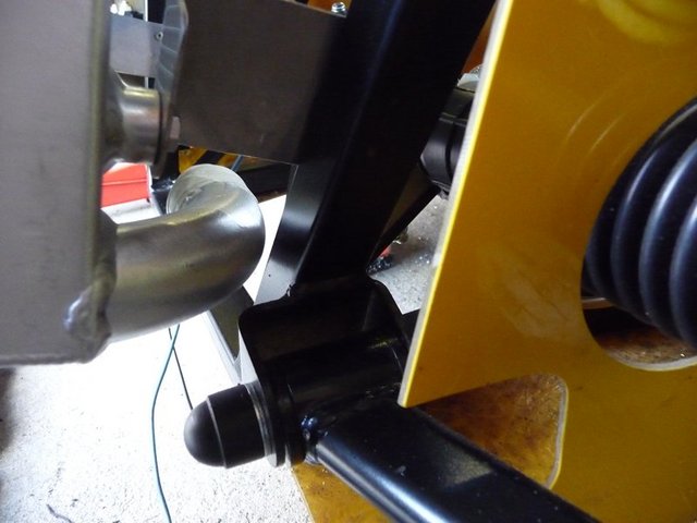

Next job was to test fit the rad/intercooler. I have recycled the old 1.5mm thick stainless brackets I made for the original polo radiator, and just
chopped them about a bit so that they suit the new rad/intercooler. I had to make sure that it was as close to chassis as possible, but still allowing
space for the rad fan behind it as it is so thick there is no room at all to spare in the front.
rad fitting 1
Rad fitting 2
Once I was happy with the position of it, the brackets were riveted to the chassis. And this is how its all ened up. Very happy with the fitment.
Theres 3mm clear to the chassis on the bottom hose, and the same to the intercooler hoses in the nose.
Rad fitting 3
Rad fitting 4
Rad fitting 5
Rad fitting6
Rad fitting 7
