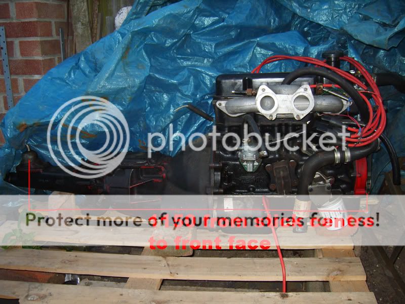

Took my xflkow out a few weeks back so you're welcome to borrow bits to see if it helps, im only 40 miles from you, have pertronix electronic ignition/coil etc all sitting about at the moment until I get round to selling them.
Lights failing a bit so excuse the piccie but the length is what you're after (mm):
MakeEverything - 24/5/09 at 08:26 PM
Fantastic, Thanks Flibble. Whats the spec of the engine and how much would you want for the lot?
