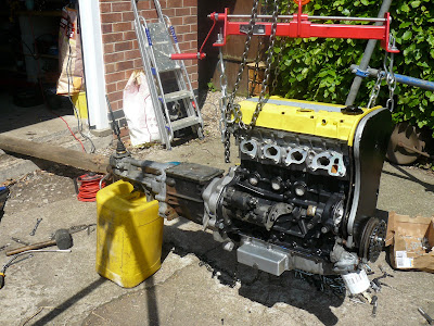

Ecotec V6 3.0 ltr, 211 Bhp, 200 lbft torque
Got further than this photo, but not on the road yet.
There is a working one on TB's in Ireland (Ni7evens)
