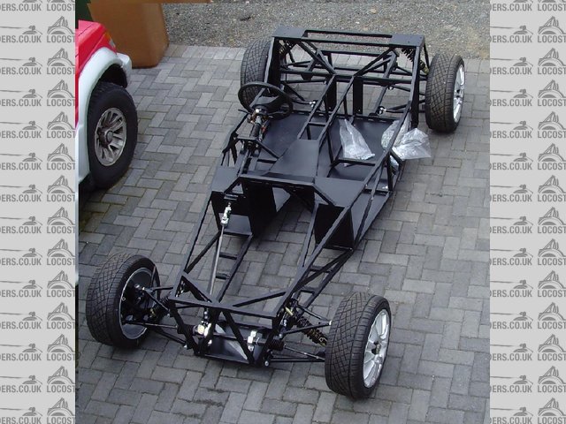

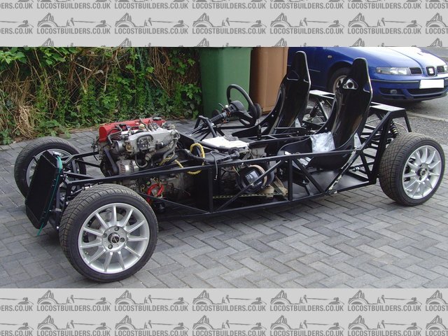

For anyone thinking about putting the F20C in a locost then please take note that the bell-housing on the F20C gearbox is big and if you buy the
chassis the engine and gearbox won't fit.
I thought about a BEC too but was put off by the maintenance and the need for being able to reverse if putting the car on the road.
Here is a picture of my work in progress and notice the elevated part of the chassis near the bell-housing. (also remember you need it high enough to
get the engine unless you're prepared to always split the box from the engine to do this, in which case it will be difficult to put it back on in
place).
sorry.. i'll try again. If I fail could anyone tell me how you put a picture on this thing?? I'm new.
it worked! I'm playing now to learn how to get a more suitably sized picture, so here's a picture that shows more clearly the taller part of
the chassis for the bell-housing and the foot-well is slightly narrower.
