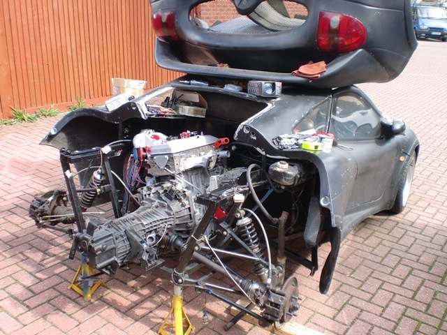

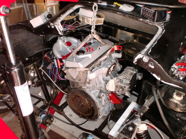

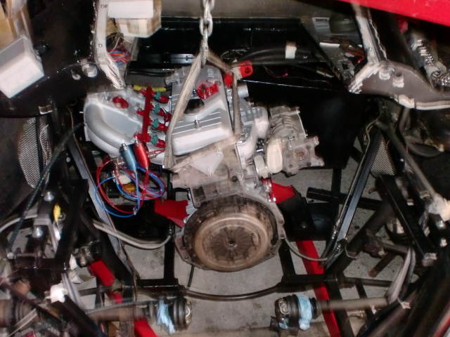

I got so fed up with the problems assciated with fitting the 2.9 cosworth engine, i thought i would change tack slightly.
I bought a renault turbo engine home yesterday from Bournemouth, and after 8 hours of fiddling, managed to get it fitted to the car with the
transmission attached today.
It needs to come out for a bit more work on the engine itself, but the engine mounts are sorted, and the engine sits really nice in the chassis.
The plan now is to get it working and Megasquirt set up so that i can drive it to the shows etc. The 2.9 cosworth and Transaxle will be a side
project and the ultimate end picture.
Just thought id share my news. Im really pleased its in and taking shape. I even drafted in the old man for a few hours which is great to have some
help at last.

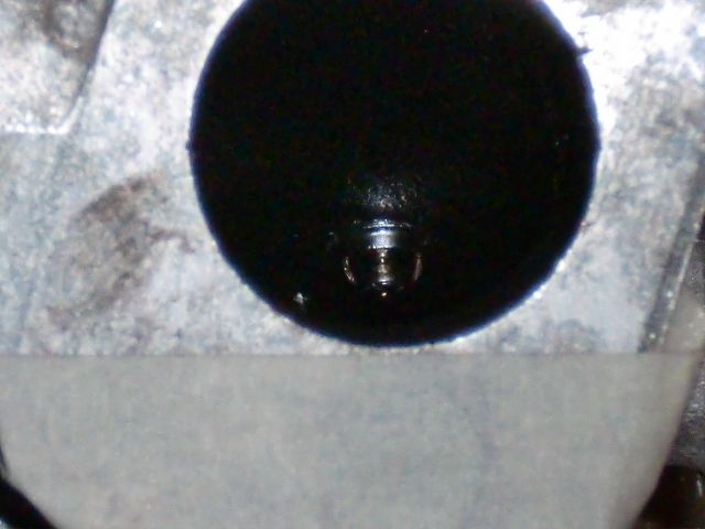

Last night i was working away removing the old exhaust manifold studs in preparation for the new ones to arrive, and the inevitable happened....
The last bolt sheared off flush with the head.
This morning i got straight to work with the drikk and tap, and this is the result.
Studs Extracted
Happy days!

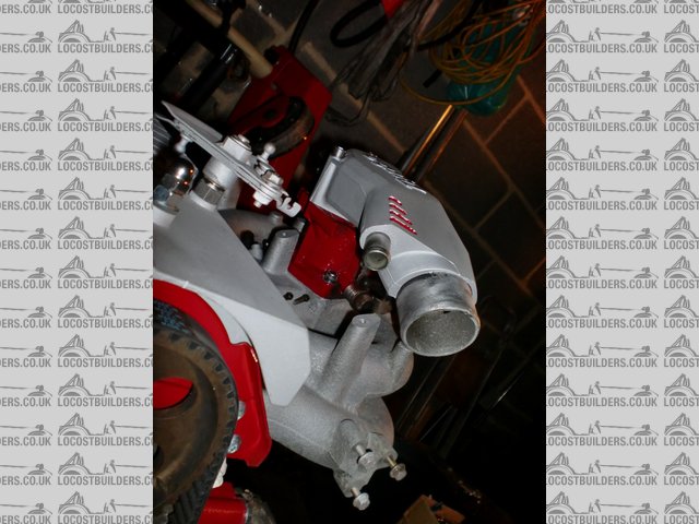

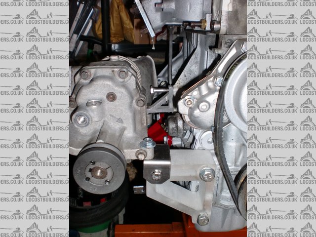

After breaking the first taper lock trying to shoe-horn it onto the shaft (too small) i ordered a larger one with a 20mm bore yesterday. It came this
morning, so i fitted it this afternoon.
These are the results. Sorry about the poor top photo. Its heavy to hold with one hand and take a photo at the same time!!
Supercharger Mount
SC Pulley on
looooooknnn ggooooddddd
Looking even better now!!
Charger Mock Up 1
Progress.....
One of the bolts is very loose on the far LHS of the pump, so although its loctited in, its not doing much. Im hoping that the other bolts and the
gasket will do their jobs! I know its not ideal, but i may look at something later on before the engine goes in for final fitting.
Water Pump on

Just getting some Ali cut for the front bracket, and i'll make one for the rear once it arrives. The front wone will look like this;
Supercharger Bracket

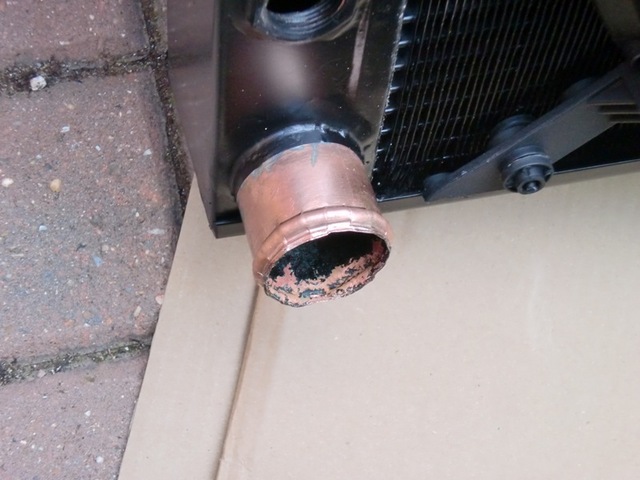

Managed to get the TIG welder working better again, and penetrating the thicker metal. Didnt have enough amps for the other stuff!! derrrr,
schoolboy error!
This is the result of the bottom hose;
Bottom Hose Welded and Fitted
Sadly, i managed to get the top hose done first but spot the error.....
Top Hose SPOT THE ERROR
I need to get another and try again!
Afraid so! Got another one coming, rather than grind it off, as the surface needs to be flat.

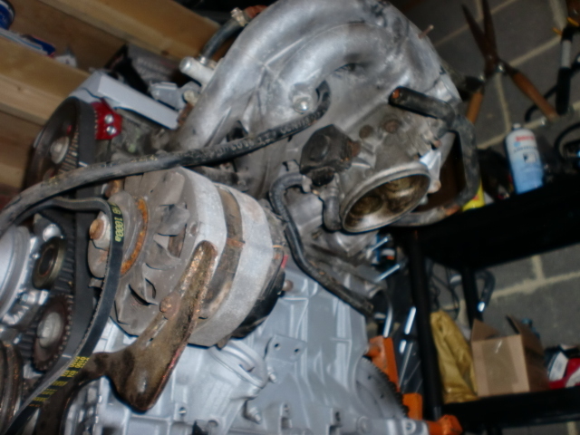

I knew i had a box of boost hoses from the 7T that i bought as spare, but i forgot that i had kept the exhaust manifold as well!
I think it will foul the supercharger, as its not as compact as the turbo manifold, so ill have to play with it once the bracket arrives.
Look what i found in the garag
Also, in the 10 minutes i was out there, i grabbed the grinder and cut the alternator bracket off of the power steering pump. I need to remove some
of the excess metal and strengthen it again, but it looks good so far.
Alternator Bracket

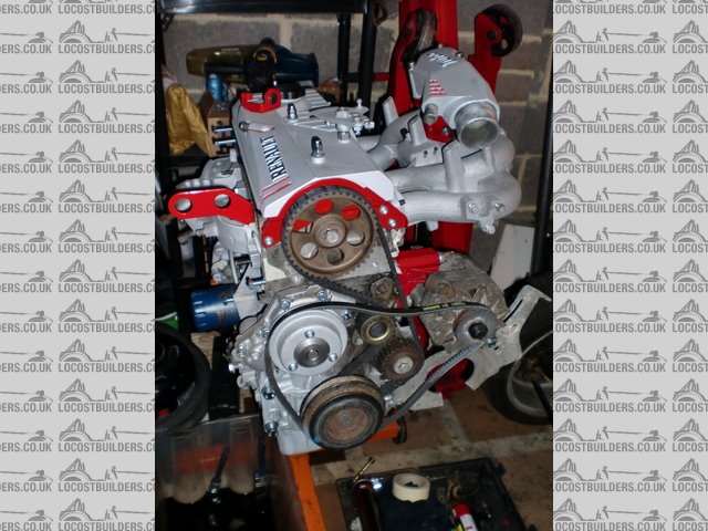

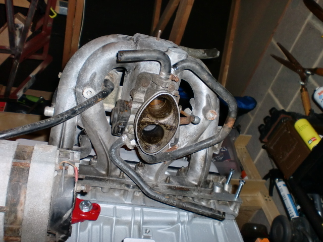

Got busy when i got in from work.
Painted Cam Cover
Also did a bit of cooking....
cooking
And i carried on.....
Shiney covers 2
shiney covers 1
And the peace de resistance......
Covers on engine

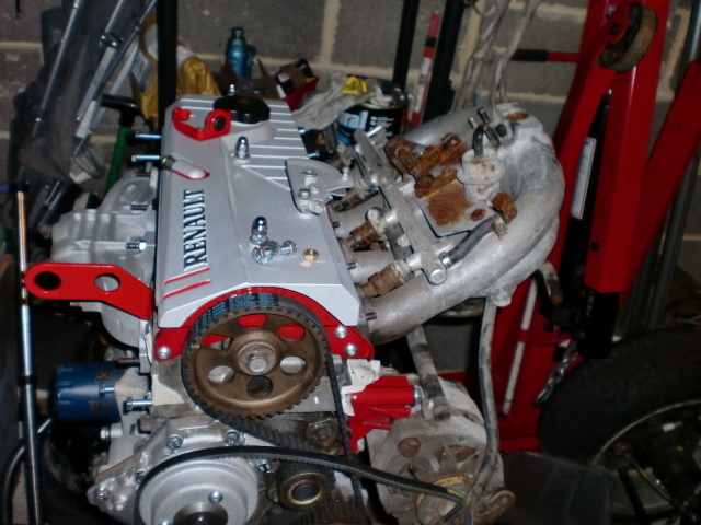

I love how this looks now. With the red silicone hoses, its going to look awesome.
Yes, it does look good.
But, all that rust and dirt on the head is
Take it apart and clean it up.
Do it once, Do it properly
[Edited on 29/7/10 by l0rd]

Sorry my bad
Meant rust on the engine such as alternator, pulleys etc..
Dirt, i meant on the head and the inlet manifold.
BTW the colour of the rocker cover and the turbo cover is excellent.
What is it? From different angles, it looks like whiteish
Its VHT Aluminium colour.

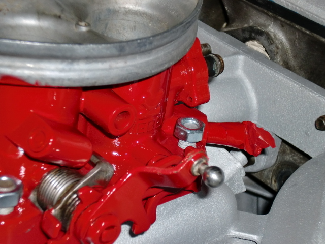

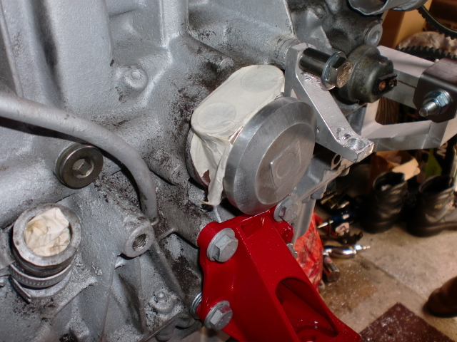

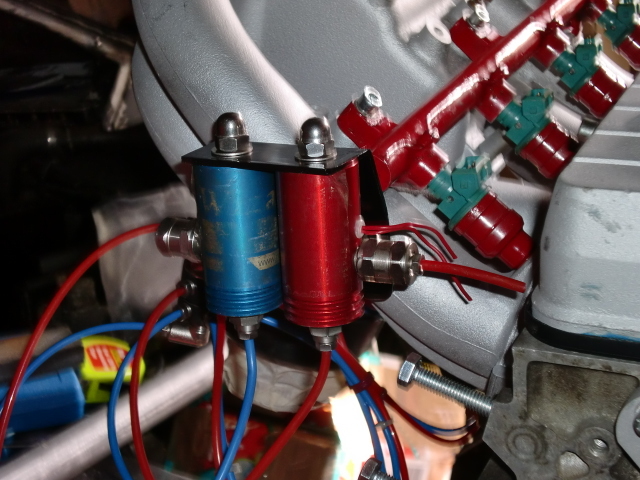

I sprayed two coats onto both covers, and rubbed the letters off with a sponge sanding block.
The two lines next to renault now sport red insides! I plan on doing the 5 lines on the other cover too, just to break the colour up a bit.
The top mechanisms are all painted (Red) now and are drying. The pulleys will get cleaned, as will the inlet which will also be painted. The
throttle body needs stripping and cleaning anyway.
Im replacing the alternator ultimately, but for now, ive got another (cleaner) one which will do.
The supercharger will also get some paint, though im thinking of an idea to make the whole thing stand out...... watch this space, but it does
involve red, and the gearbox as well.....
Oh, and ive painted the exhaust manifold with a 700 degree silver paint too.
Is this ok for you??
A Touch of Red
[Edited on 29-7-10 by MakeEverything]

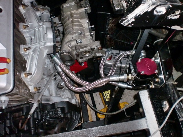

So, Weekend arrived. Time for a mock up supercharger fitment.

Also stripped, cleaned and 'serviced' (not much you can do with a TB if the springs and shaft are ok) then painted with red enamel to match
the rest of the engine. Really pleased with the nice glossy finish. same with the timing belt dust cover too.
Red TB

Ive stripped the 7T of its engine mounts and inlet, as well as alternator.
The manifold fits directly onto the 7R and ive had some discussion with AndyQuadra regarding is origin. We are presently stumped as to what it was
from, but it does have a WEBER twin butterfly throttle body both with a bore of 37mm. First one opens up to half throttle, then the second to full
throttle. This may help stabilise the idle, and give me more control over power delivery.
Anyway, here are some pictures of it and my nice clean (now painted) injectors.
Painted Injector
Inverted Manifold 1
Inverted Manifold 3
Inverted Manifold 4
The "Inverted" manifold may be better for me, and utilise the void below it rather than the tight space above. It will also keep the centre
of gravity lower. :rockon::clap2::clap2:

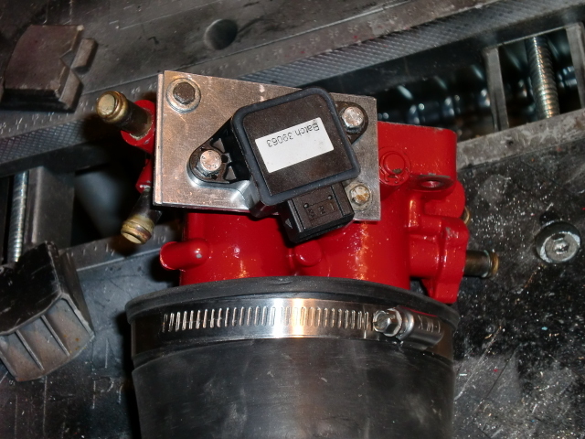

And a close up of the Twin Barrell Throttle Body, sporting a clean TPS.
Clean twin barrell

I fitted the supercharger a little more permanently tonight as a trial fit to make sure its not too weak, only being supported at two points. I think
i might add some more mounting points later on, but for now it will get the engine in and serving its purpose.
Supercharger 1
With the way that i have mounted the supercharger, allows for a little movement laterally as well as longitudinally, so i can adjust the position for
the belt, to ensure correct alignment and tension. In hindsight, this was a good move, seeing as the measurements were impossible to get 100% spot
on.
Supercharger 2

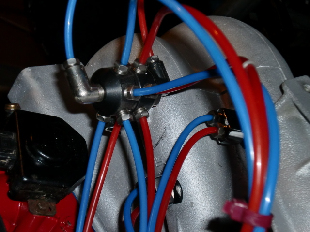

Foggers mounted into the inlet;
Manifold Nozzles in
Fogger closeup
Inlet fogger
And with the 4mm nylon pipework connected. I plan to make some more at the correct lengths, but for now, the existing ones will do;
Nitrous connected
Manifold
The inlet manifold is mounted upside down, so that i can work on it easily. Needless to say, i DIDNT drill the manifold with it attached to the
engine, and it will be blown out before final fitment again.

Had a good start to the day. Managed to get the oil filter remote takeoff drilled and tapped to 20mm (19mm drill bit came today), and fitted to the
car.
Oil Filter Remote fitted 1
With barely enough room, even after grinding off the wrench stud.
Oil Filter Remote Fitted 2
This should be ok, as it i can use a strap wrench to remove it if i need to later on. Not sure if it will still be a problem after ive adjusted for
tightening the belt, but will see.

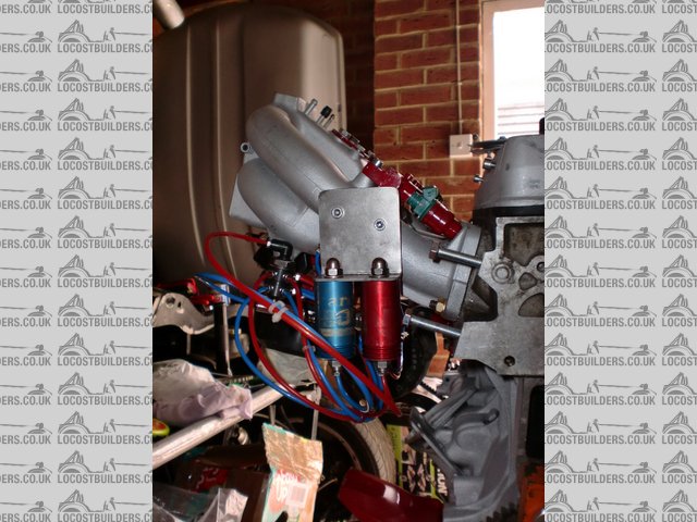

Also, i got fed up with moving the nitrous solenoids around the garage, so i knocked up a bracket for these that i had measured a template for before
going on holiday. This is the result;
Nitrous Solenoids Mounted
Looks quite nice and compact, though i might see if i can get some M6 countersunk screws and turn the bracket the other way up to make it even more
compact. Watch this space.
Thats Better;
Solenoid Bracket 1
Solenoid Bracket 2

Had a slow start to the day today. Expecting some rain at 10:00, i waited to see what the weather was going to do before dragging stuff out of the
garage.
Managed to get the engine in its original mounts again;
Engine Trial Fit 1
Engine Trial Fit 2
The supercharger hits the fuel tank and needs another 40-50mm clearance to fit and move. Next job is to modify the tank, check everything again and
refit once its all clean.
Charger Vs Tank!
Todays final efforts with all modifications made to Tank VR mount, supercharger adjustment and timing belt. Turned over by hand very well.
Todays efforts! :)
Progress from todays efforts.
She's in 1
She's in 2
She's in 3
Then it absolutely hammered down with rain!! The car got soaked, so is now drying out in the garage!
She's in 4
Next up, Wiring, Inlet plumbing, exhaust.

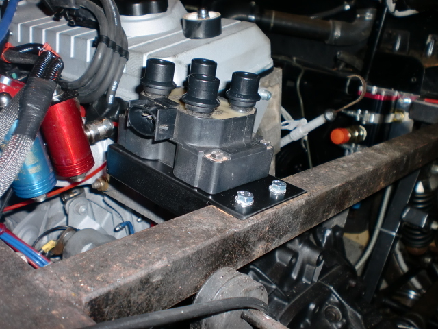

Tonight, i also managed to make a start on the wiring, which i started to enjoy (as suspected) once i eventually got stuck in. Managed to get the two
relays wired and the fuse box wired up. Just need to complete all the field wiring and get it done.
Wiring 1
Wiring 2
This is all working from my own wiring diagram, so i hope its right!!!!!
Wiring 3

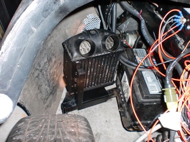

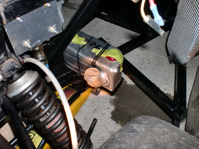

My new radiator arrived today, which i had made to replace the old Austin Maestro unit. It is three rows (Not triple pass as originally thought!) and
made of copper. As a result of the Copper material, it is a little heavier than i would have liked, but its repairable rather than disposable!!
New Rad
As with the water hose takeoffs that i made, the pipework is the same size, to prevent the need for reducers and subsequent pipework. I had to swage

After a bit of work, my new oil filter remote and heat exchanger arrived today.
Not feeling great, so these wont get fitted until later in the week.
Oil Filter / Heat Exchanger
........... or maybe sooner......
Oil remote fitted
Oil remote fitted 2

S/C Inlet welded up
Got the inlet flange welded up, but i think this might strangle the inlet a bit. I think ill open this out at a later date, as in my enthusiasm to
trial fit, i managed to get it stuck on the supercharger!
S/C Inlet welded up2
S/C Inlet welded up3
The other job i finished was the Coil Pack bracket. Looks quite good, and is simple, yet effective.
Coil Pack Fitted
Coil Pack Fitted2

painful jobs out of the way. Cut and welded a bracket for the heat exchanger, then mounted it with cable ties temporarily.
Heat Exchanger fitted
Also managed to finish off the intercooler bracket, and get this in situ. Once im finished with the TPS and inlet, ill mount this permanently.
Intercooler Fitted
Trouble is, the new TPS i bought is a lot smaller, and has less girth than the original, so im on the lookout for a new original, or some brackets to
take up the gap between it and the throttle body.
TPS problem!

Went outside when X Factor started, with the intention of only fitting the TPS.
New TPS Fitted
Got the TPS fitted, tested, set up as well as the TB Fitted back onto the inlet, and a couple of other little jobs finished.

The radiator came back modified, so there are no nylon ties through the core, and the pins have been moved to move the radiator forward a bit.
Trouble is, now i need to move the heat exchanger bracket that i put in a couple of weeks ago! Its only a 10 minute job, so ill do this when i get

On monday, i also managed to get the oil hoses made up and installed;
Oil Hoses In

Put the finishing touches on the nitrous kit, plugging the four surplus holes in the 6cyl distribution block. Just the wiring to go.
Managed to get some jubilee clips on the coolant hoses (Thanks Davegtst) and the coil pack put into the bracket.
All the little jobs coming together.....
Finally managed to fit the last jubilee clip to the coolant system, and fill it up. 2L of neat coolant and about 8L of water......
I could hear a dribble, but couldnt see it. Looked for about 5 minutes, and had to get the missus's mirror to look underneath. One of the hoses
was a bit loose, so i nipped it up and it slowed down. However.......
......theres water in the bottom of the radiator between the fins, and its dripping onto the floor. Im hoping its just another loose hose clip and
not a leaking radiator that cost me nearly £300.
Will keep you posted, but i suspect that all of the coolant will be on the garage floor by morning.
All sorted now. It was another dodgy Jubilee Clip.

TB Stuck Open
Looks like the idle screw is set incorrectly, causing the problem. I need to think whether i want to re-fit this once repaired, or fit the other
manifold.....
[Edited on 18-1-11 by MakeEverything]
Well, i took the manifold off, plugged all possible air leak offenders, and put the manifold back on. IVe taken a video of the results which im
uploading now. All i can say is that theyre good!!
Really happy now, as this is real progress.
The smoke is (im hoping) as a result of starting and stopping and having not been under load for a while. It should clear once its up to temperature
and run for a while.

After Too-ing and Fro-ing from B&Q, i finally managed to get in the garage and get some work done.
These are the photos of todays progress;
The nibbler is the best tool ive ever used. Soooo efficient, and safe too. Highly Recommended (AB Tools?)
Nibbler
Inlet
The Supercharger exhaust is all finished.
SC Discharge
sc discharge 2
A good days work. Should have the inlet (air filter inlet) done by tomorrow.

These are the photos of todays efforts. The boost hoses themselves didnt actually take that long, but i ran out of hoses. Thanks to Andy for the
help and the flexible hose, and to Toxic Rides for making two new elbows available.
New coolant bottle in place. From a Jeep Cherokee, apparently.
New bottle in place
Yeah yeah, i know the blue is a bit out of place, but im not bothered at this stage. Just want to get it going now. Its sooooo close!
Boost Hoses 1
These were a challenge to get in.
Boost Hoses 2
Picture of the dump valve and where the hoses poke.
Dump Valve in
All in all, a good days work. Going to check the megasquirt settings tonight, so make sure im doing it right!
Over the weekend i managed to make a back plate for the electrics, and install the IAT sensor into one of the hoses from the intercooler. Its been
curing on the radiator since sunday, and i remembered it last night!
IAT
IAT2

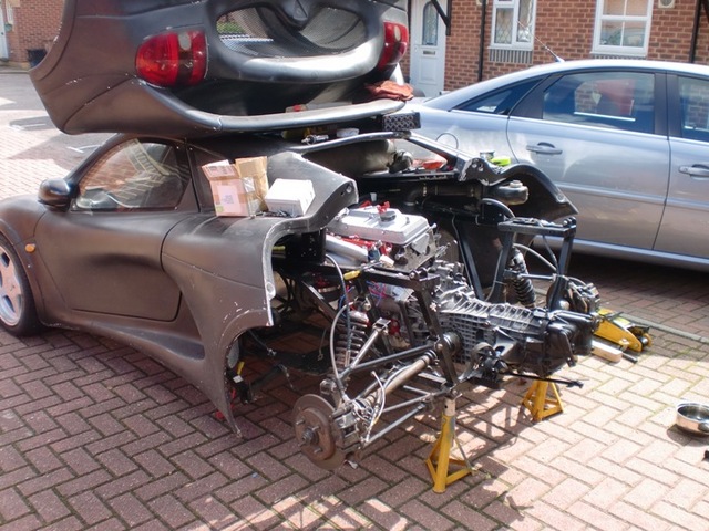

The clutch slave held out and works really well. I also took the rear of the car off and removed the spoiler ready for collection by the old man on
Wednesday, who is going to fibreglass the holes and blend it all in. I think hes also going to prep and paint the whole thing afterwards.
These are the photos from this mornings efforts;
How it looks all put together
Next up, is a bloody good clear up! Then its brakes, secure everything down and check everything, gear oil change and MOT.

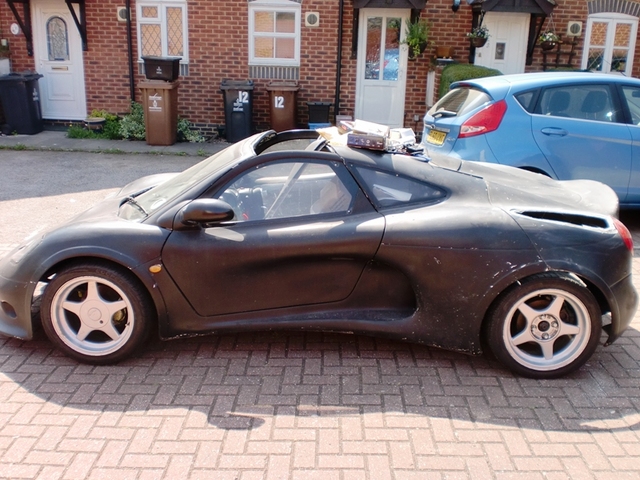

Well, im there. I'm sorely tempted to drive it to the MOT station as is, but really should have a working alternator first! I am waiting to see
if i can get a known good (new) alternator this evening before i buy one. Here is the car;
Really pleased with it and the way it drives already, but it is uber loud!
Looks good but it needs a proper paint job

Well ive had to take the engine out to replace the lower alternator bolts due to stripping the threads. Now ive got it out, im thinking i might take
advantage and do a little bit more;
Now im looking at some jobs to make my life easier and improve reliability;

Had a good productive afternoon once i got going. Managed to remove the supercharger and make up a tensioner on the existing brackets. Somehow, the
nose is dipping down so the belt is twisting slightly now, but ill sort that next time i go out there (5 minute job). The belt is now much tighter
with 8-10mm play, and the alternator is also the same.
Once its all finished, ill take the brackets out, clean them and powdercoat the steel ones with my powder coating machine.
I also re-made the VR bracket more secure, to prevent the sensor moving around. This is much better, and should avoid any problems as it is also
independently mounted as opposed to sharing the S/C mounting bolts. It is still very close to the S/C belt, but ill keep an eye on it. At worst, the
bracket will bend away from the trigger wheel and stop the car from running.

Had a go with the soda blaster whilst everything in the street is already white, and these are the results.
This was setting up the blaster, as i had to take the metering jet out (broken in transit).
Then i finally got the hang of it. Believe it or not, the BLACK is the cleaned area (Ali oxide is white).
(Yes i know the engine plate is missing, but i took it off to drill out the broken rivet and replace it once cleaned.)
Then i wondered what it would be like on the rust inside the block;
All in all, some pretty good results. Just need to get some goggles and a dust mask!!

My fuel pump sounds as though its straining, so i changed the HP filter, and found this;
Perfectly clear on the outlet, but the inlet was like diahorrea!
Hmmm. Changed it, and still sounds like its struggling after a few seconds. Could it be the FPR....?

I sorted the fuel problem. The advice i had was that the inlet to the FPR was at the bottom, but that wasnt working. When i took the hose off, i
ended up wearing about a pint of fuel at 4Bar! It stings in the ball bag area as well, so i dont recommend it. Hoses swapped, it now seems to be all
good and idle is stable at about 600RPM.

It passed the MOT!!! Now I just need to tune it!

Its alive again!!
I got so fed up with Megasquirt and also the development using a supercharger; especially with the weather we've had, so ive gone standard with a
renault 21 ECU and loom, and a T34 Turbocharger (Ok, well not completely standard!!).

Nect job on the list is intercooler, battery mount and boost hoses, rather than having it directly piped in as it is now!
