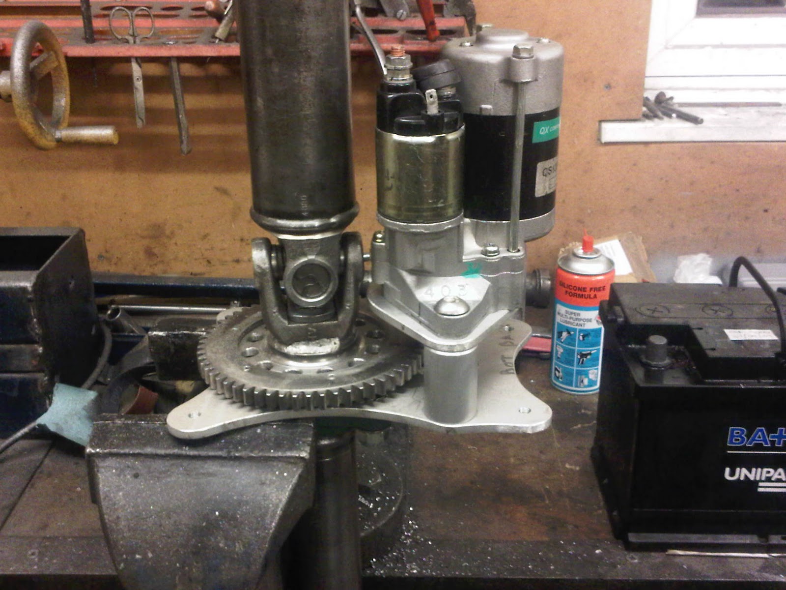

We have used the starter ring from the r1 clutch basket, it meshes perfectly, let me dig a photo out
here you go, the starter ring was removed from the basket
And then fitted to our idler gear
Cheers but that is no good for my setup, I need a small purpose made gear that bolts onto toe output shaft on the front sprocket shaft, the starter
mounts on the left side of the engine onto a custom made plate to allow the strater to fire forward to engage the cog and giving it the direct drive
backwards.
Like this:
Yeah that's same setup really, apart from we drive our idler gear rather than the engine sprocket end. You need to careful how small you go with the sprocket, you could end up with not enough torque to move the car or it reversed a bit quick
This is the set up on the fury, only its using a civic starter so going the wrong way for you, but principles exactly the same
I hear what your saying, but mine is chain drive, not propshaft. The pic I sent is the actual kit fitted on my type of trike with the lynx kit. I am just trying to keep the cost down as if I buy it all from them its a nice £312 which is a big chunk of cash for a starter and cog.
My new car using the Scooby starter is chain drive
Cheers for your help by the way
