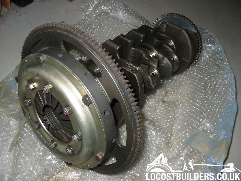

Reground crank assembled with new timing disc, steel flywheel, twin plate clutch and then balanced:
crank1

Is that a steel flywheel Ned (I guess so) if so how much if you don't mind me asking?
think it was about £80 Nat..
2.6kg or so + ring gear!
http://www.locostbuilders.co.uk/upload/IMG_1445.jpg
[Edited on 24/1/06 by ned]
