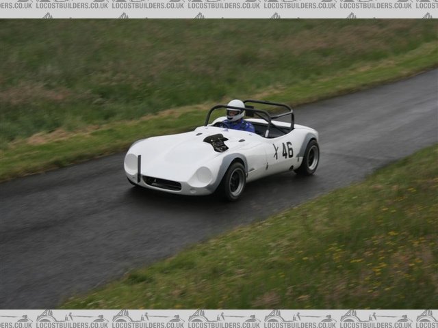

This car weighs 438kg, has a standard Busa engine and 8 inch wide rear tyres and a quaife freelander diff. Spat out of the corners like a cork from a
gun. The gering and gearshift itself must have been a huge factor. Awesome.

i'll not enter deeply into the bec/cec discussion, but that cage on the fury busa looks really useful

The driver of the Fury Busa is 63...
(And yes, the cage does look a bit short from that angle/ Must have a right good look next time out.
