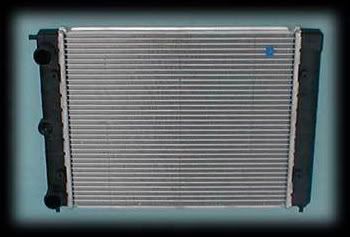

Hi, After a new years party somehow my radiators become broken - who and when is being investigated but no one knows lol. The core is fine but the
core support has the locator bracket broken which has also made a hole through the core support. Can this be fixed? ie can we get a new side core
support or do we have to buy a whole new one?
If we need a new one does anyone know what this radiator is(Its upside down but is the £68 one off MNR site)
Whilst it was dropped the fan was attached. Can we check this is ok by connecting the terminals straight to a 12v car battery or do we need to fuse
it?
Cheeers
Adam

Vw polo I think.

polo rad 38 quid at partco

POLO 1093 CC & 1275 CC from 1983 - 1992

The part number to ask for is a VW302 I got mine from local radiator specialist and was 45.83 inc. vat

as already stated, VW Polo or Golf.
i am using a golf one, slightlty bigger, but i dont have an MNR.
got mine from here( see below) within 2 days, have a look at the sizes.
http://www.car-radiators.org.uk/

Cheers Stuart and Meany as the VW302 corresponds to the 302 on the link and is the exact same size plus its only £38.48 which is qutie a bit less than
the £68 MNR price

Just to update i ordered through http://www.car-radiators.org.uk came in 2 days and very happy. Marginally different from original but after a slight
dremmel on bottom locating pin all was fine.
