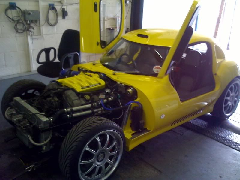

grazzledazzle
posted on 20/5/09 at 07:13 PM Reply With Quote
I think if i was going to the hassle of building something with a difficult engine again i wouldn't choose the st200 engine again.... if you are making the effort i think i would get a bmw straight six in there.
